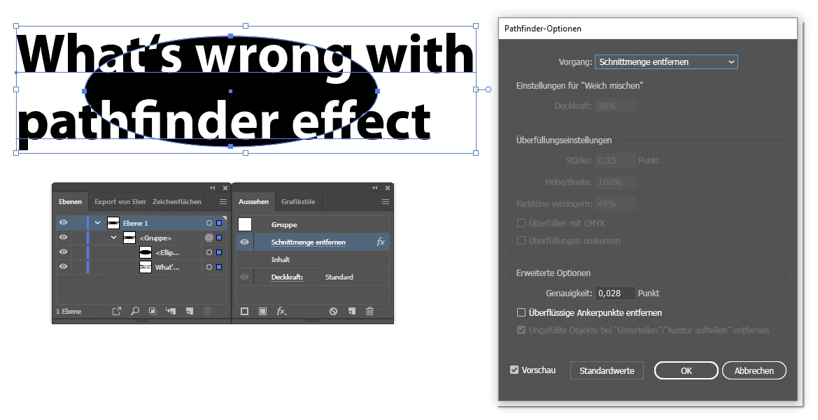

Came across this simple yet elegant effect and always wondered if this can be replicated easily through overlays and effects in Illustrator. I would like to keep text editable and the only method I'm aware of is compound shapes and exclude using Pathfinder, which isn't ideal.

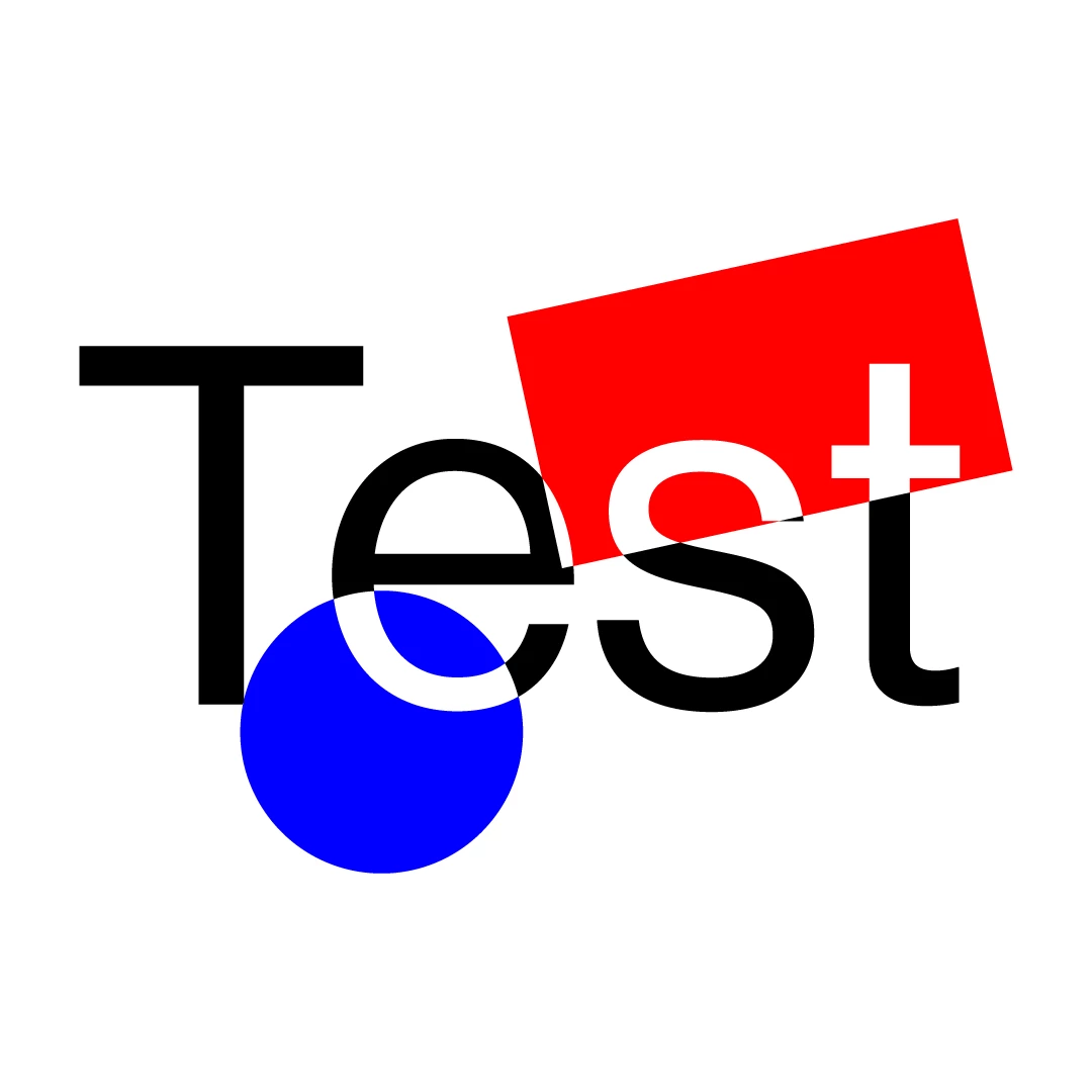

    Hi! First of all, thanks for showing how to achieve this effect. After trying it out and seeing how it works, I was wondering if it would be possible to take it a step further.
    My goal is to recreate the same effect, but with added control over color (while still keeping the text fully editable). In other words, I’d like to be able to change both the color of the overlapping shapes and the text itself (as shown in the attached image).
    I’ve experimented with transparencies, blending modes, and opacity masks, but every approach seems to require duplicating the text. Ideally, I’d like to keep the effect as editable and simple as possible.
    Any ideas on how this could be achieved?
    Best regards,
    Dani
    October 2, 2025
    Sorry, it seems I didn't attach the image correctly. This is the effect I'm trying to achieve:
    Monika Gause
    October 2, 2025
    It would be possible using appearances and Pathfinder effects. But: unfortunately this is not how the Intersect Pathfinder nor the Pathfinder effect of the same name work. They only react when all the shapes overlap in the same area.

    December 6, 2018
    WHat's wrong with Compound shapes?
    December 6, 2018
    I'd like to retain the ability to edit text and move the shape(s) around as needed. There are also added steps to the process of using compound shapes.
