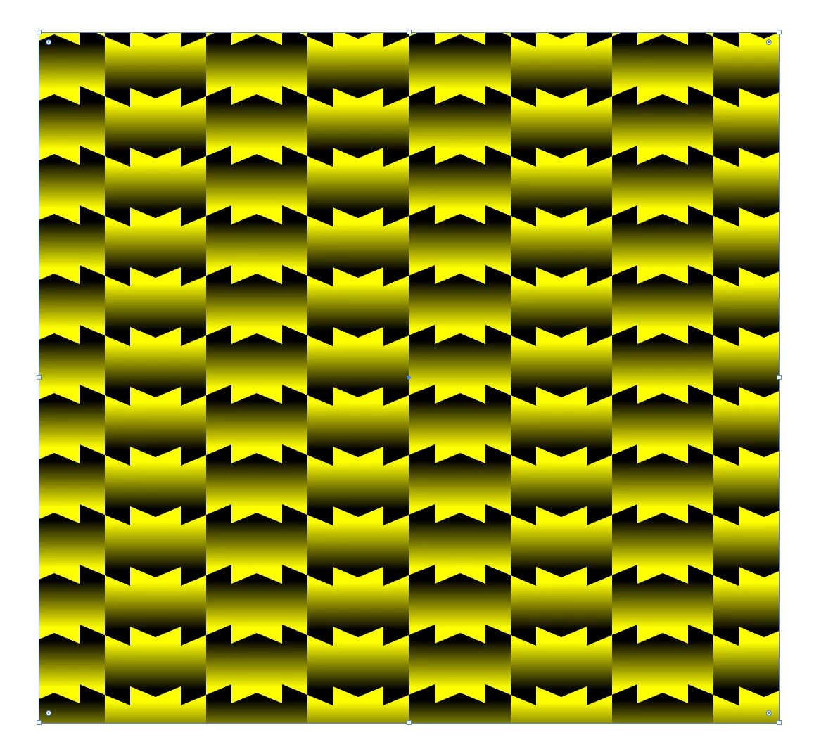

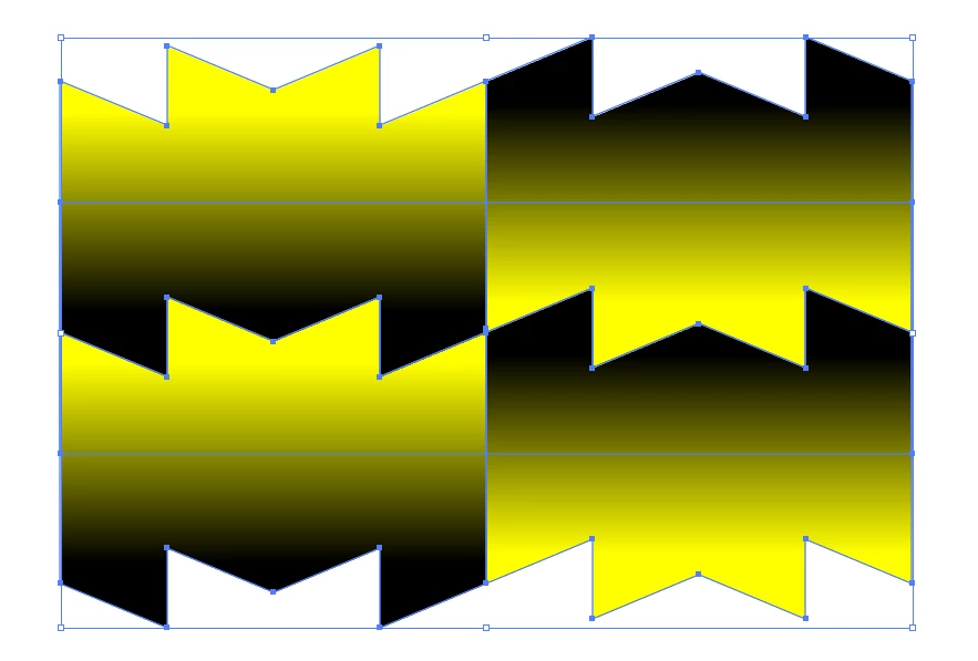

    here's your basic shape. position them into the stylized 'm', use pathfinder unite and give it a gradient:
    position four of them together like so:
    here's outline mode so you can see the no stroke/fill box i'm using to define the pattern boundaries. its top and bottom are aligned to the centre of the shapes (use smart guides):
    drag all five shapes to the swatches palette and voila:
    Doug A Roberts
    Doug A RobertsCommunity ExpertCorrect answer
    May 10, 2017

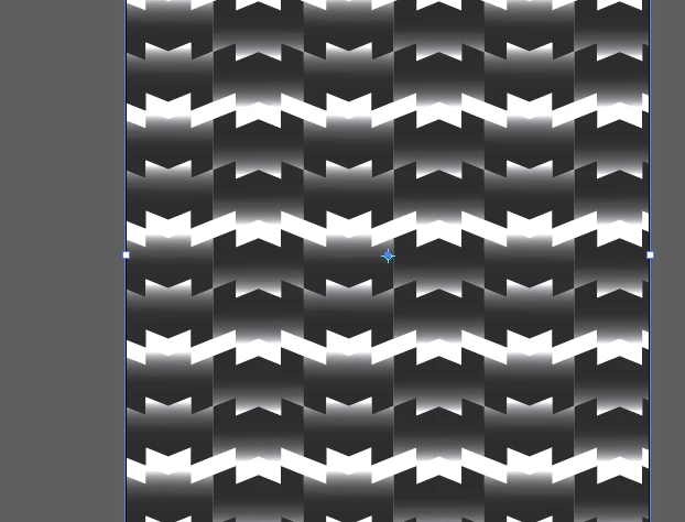

    ultrAslan
    ultrAslanAuthor
    May 10, 2017
    I get white lines like this:
    What am I doing wrong?
    Monika Gause
    May 10, 2017
    You did not create the no fill/no stroke rectangle. Or you created it wrong.
