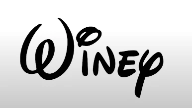

I'm trying to fragment this word into several shapes.
As such:

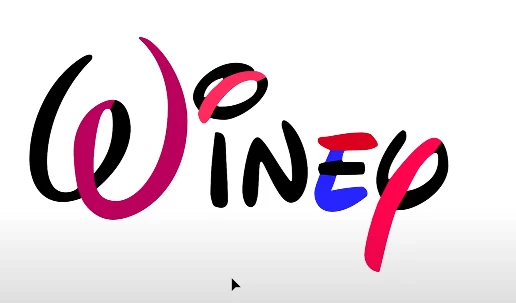

I want one layer for each colored segment shown above.
I know how to turn the word into shape layers, outline each letter, have them on a distinct layer each.
I was able to do the W using the Pen Tool + Pathfinder Panel.
But other segments are much trickier. The dot of the i for instance. Not only do I have to separete each parte but as you can see on the images I also have to connect the central part of it, other wise the dash is going to be open.

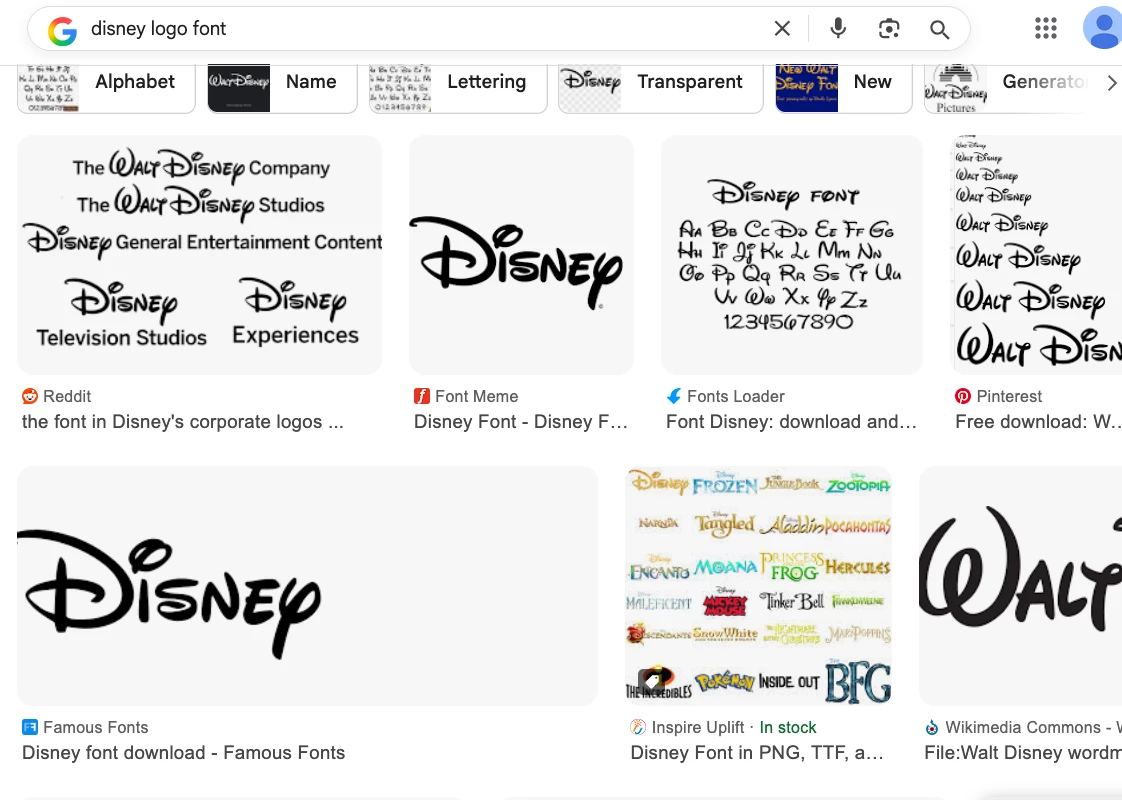

Calai, hi.
Not sure what your ultimate goal here is. ???
It’s quite obvious you have selected Disney’s custom font. There are many knock offs.
Disney does not take to kindly to infringing upon their copyright laws.
Trend lightly.
K
CalaiAuthor
September 7, 2025
Hope I don't get into trouble. I'm not using commercially. I'm just following a youtube tutorial. The name of the font is Waltograph
Jacob Bugge
September 6, 2025
Calai,
I am afraid you will hear from the House of Mouse if you use any version/elaboration of this for any public purpose.
Obviously, if you create the letters yourself, you will start with the full shapes they were originally created from, and then you can just use those for the muticoloured version as well.

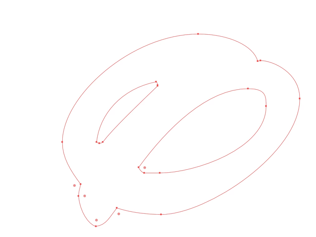

If I could see the anchor points on the shapes I might be able to give a more precise answer.

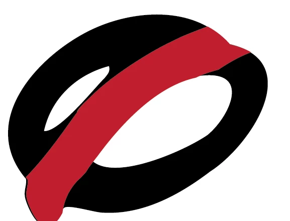

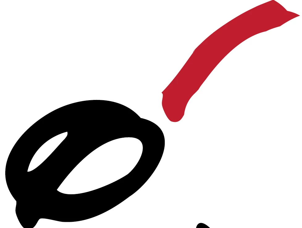

One way you could do it would be to duplicate the shape, like the dot on the 'i'.
Color the duplicate red.
Use the eraser tool to remove the parts you don't want on the red.
Overlay the red shape on to the black dot.

I need to separate this into 3 shape layers
One for the "left handle" another layer for the central dash (the one you show in red), and another layer for the "right handle".
The middle dash is tricky because I also need to draw connections so it's one runing thing without opening.

But Referring to your screenshot with markings below, you can also do it in a coarser/simplified way as follows, still with unchanged unchanged visible parts of the original path, based on drawing by eye with the Pen Tool, Smart Guides being your friends:
First copy your i dot twice on top of itself and lock and hide the original and the first copy, and work on the second copy;
Then with the Pen Tool Click on the outside and the inside of the top right curve of the i dot path where you wish to cut it to start the dash (Smart Guides say path when you are within snapping distance, and you can move the points back and forth until you are satisfied), and then use ObjectPath>Divide Objects Below;
Now you have cut the path which remains closed with straight segments between the two new Anchor Points; this corresponds to steps 2) - 3) in my W reply;
Then with the Scissors Tool, move the cursor to each of the points, 1-1), 1-2), 2-1), 2.2), 3-1), 3-2) where Smart Guides say anchor when you are within snapping distance, make sure you snap to the bottommost of the two Anchorpoints at 3-1);
Now you have cut up the copy path; this corresponds to step 4) in my W reply;
Then with the (normal) Selection Tool select the handle parts and leave the dash part; this corresponds to step 5) in my W reply;
Then draw the curved part from 1-1) to 1-2):
  1. With the Pen Tool Click to snap to 1-1 (Smart Guides say anchor when you are within snapping distance), then ClickDrag down to the left so that the opposite mirrored Handle to the top right follows the direction of the existing curve, and so that the Handle length is about one third of the distance to 1-2),
  2. Repeat 1. only with 1-2), where you ClickDrag down to the left so that the Handle you are dragging out to the bottom left follows the direction of the existing curve;
Then draw the curved parts from 2-1) to 2-2) in the same way;
Then draw the curved parts from 3-1) to 3-2) in the same way, make sure that you snap to ;
These three steps correspond to corresponds to steps 6) - 10) in my W reply;
Now you have the dash drawn by eye;
Then switch from Stroke to Fill and give the dash its colour; this corresponds to step 11) in my W reply;
Then Show and Unlock the first copy of the i dot path, and switch from Stroke to (black) Fill; this corresponds to step 12) in my W reply;
Now you can see what it looks like;
Then select both paths and use Minus front (Pathfinder); this also corresponds to step 12) in my W reply.
