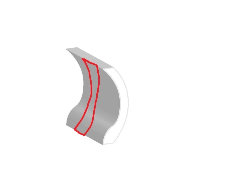

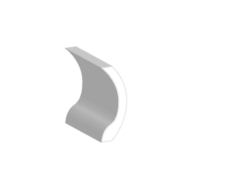

Good day,
Is it possible to cut a shape in this already existing 3D object?
Thanks for every answer

Depends on what you mean.
Assuming that is a 3D Effect object, then it is an extrusion. As long as the Effect is "live", any changes you make to the 2D base path will update the 3D extrusion. So you can make changes to the face of the object, because that is the shape being extruded. For example, you can create a hole in the face of the object by making it a Compound Path. The inner subpath(s) of the Compound Path will become Bolean subtractions in the direction of the extrusion.
But you cannot, for example, cut a hole through the sides of the extrusion because that is not derived from the base path, and because the limited feature set of 3D Effect does not let you contain different length extrusions or differently-oriented extrusions or different kinds of 3D transformations (e.g., a revolve object and an extrusion object) in the same 3D coordinate system (model).
JET
December 10, 2017
I'm actually trying to divide it into 2 halves with a hole between them like this:
Kurt Gold
Kurt GoldCommunity ExpertCorrect answer
December 10, 2017
You would have to use two separate paths with appropriate arrangements (stacking order, angle).
Depending on the desired appearance you may even have to first expand the 3D effect and construct it manually.
