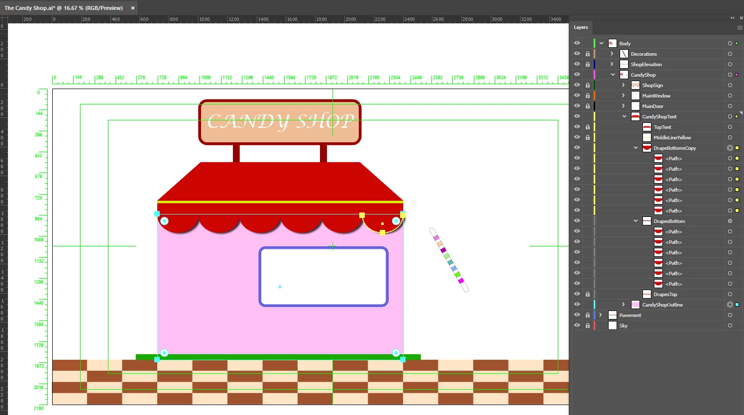

Dear Community,
I would appreciate help on the following question: how do I remove part of a dropped shadow that goes beyond intended borders?
In the example below, the dropped shadow should not go beyond the pink area.
Thanks for any help!
Alberto

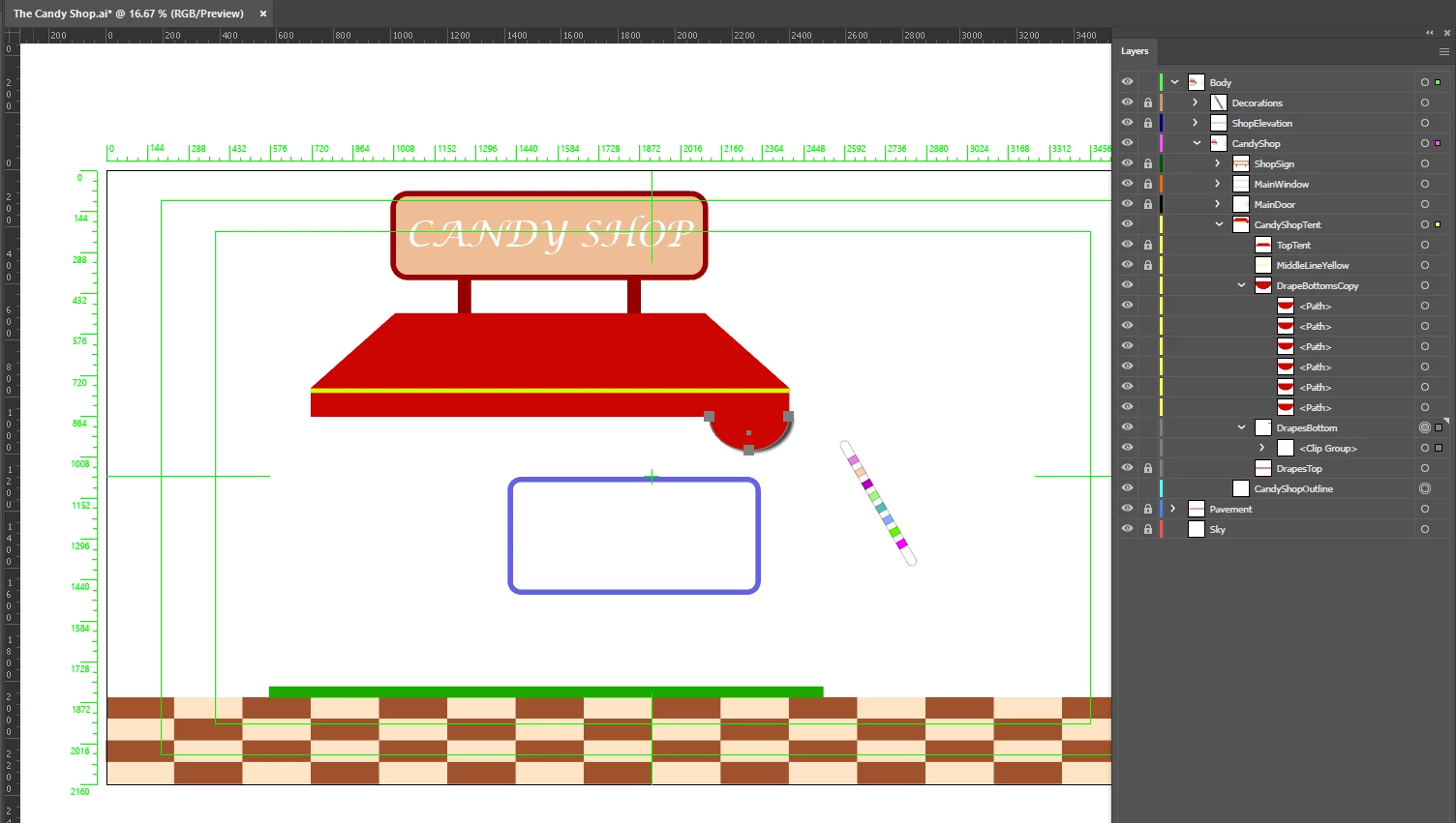

UPDATE: I do not manage to do it in my project.
I seem not to understand where to put the clipping path and am not able to understand what the final result would be.
The project looks like this:
I want to eliminate the shadow projecting beyond the pink shape.
Alberto

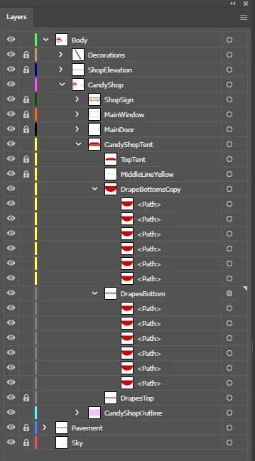

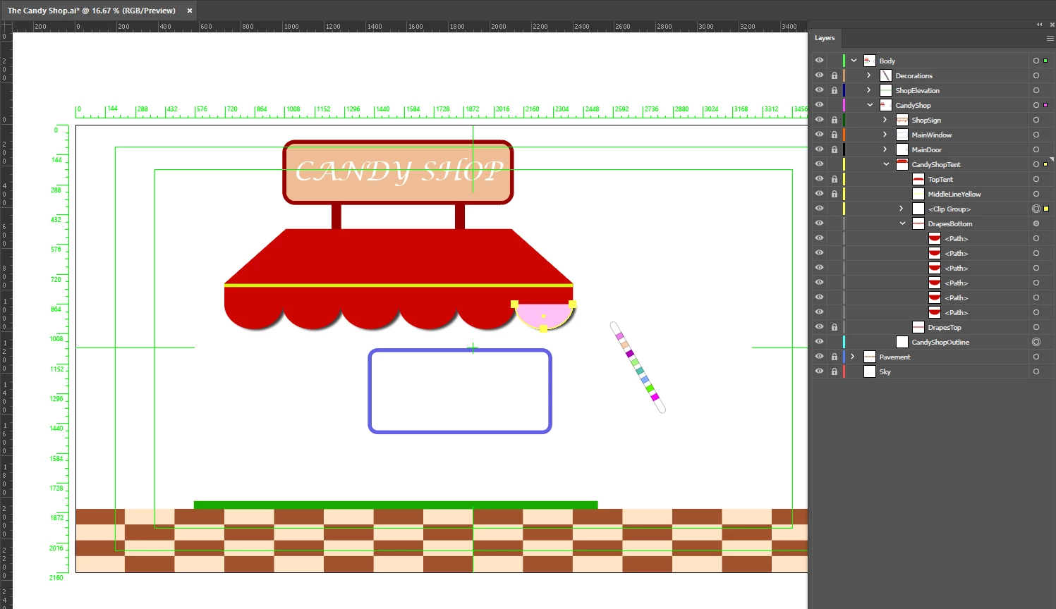

Hi Jacob, so I did as per below but things still get messy.
1. I created a new group, which I called DrapesBottomNew
2. I moved the new group just above DrapesBottom group (see screenshot)
3. I selected the DrapesBottomGroup AND the CandyShopOutline
4. I do Ctrl + 7 to do the clipping mask, but what I get is the below:
5. If I select the new group AND the CandyShopOutline
6. I get the below:
I have no idea how to make things right 😞
Alberto
