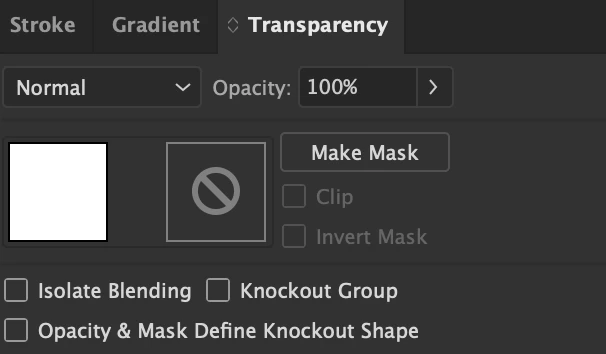

Now you need to select the grouped objects (The blue circle with the lines around it). On the side bar navigate to the transparency tab (if you don't have this you can open it by going to Window > Transparency)
With the object selected you will see a white box and a blank area like this:
Select the make mask box. Your object will disappear but this is normal. You will also notice there is now a black box next to the other box:
Click the black box. This will now allow you to create on the mask layer. while this black box is selected everything you draw, or in our case paste, will have an effect on your grouped object. Now you can paste the light blue circle from the magnifying glass into this box. However the light blue will make the object kind of transparent and weird. This is because for 100% opacity and 0% opacity the object has to be pure black or pure white. With the light blue circle selected in the mask layer change the color to black or white. If you picked one and you dont see the design try inverting the mask. My mask mode is inverted by default because i prefer using black to show and white to hide but this is just preference.
