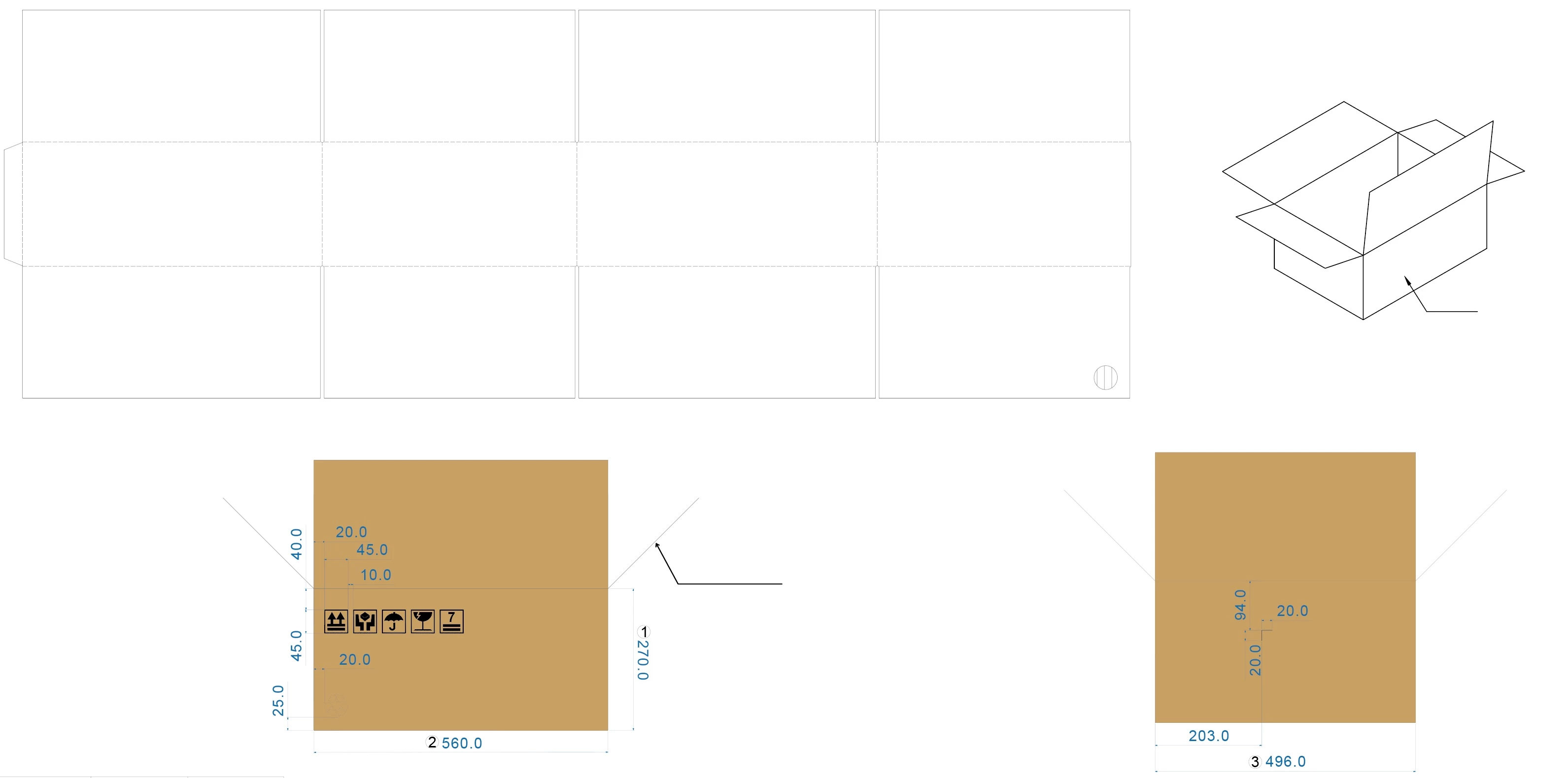

good morning,
I would like to understand how to draw the die path shown in the upper part of the image starting from the dimensions of the box (width, height, depth) indicated in the lower part of the image.
it is a double-wave corrugated cardboard box.
in this specific case, the die path shown in the upper part of the image does not have the measurements in proportion to the box and therefore I am not sure whether the cutting of the flaps is correct.
is there a tutorial or a guide for drawing the die path of a carton box?
other best practices?
thanks.

If these drawings are to be used in actual mass production of packaging, make sure to have a packaging engineer draw them. You need to respect the material, the packaged goods, the packaging process and machines.
