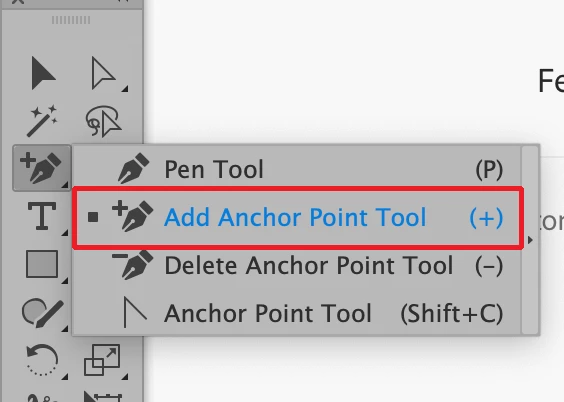

    Bill Silbert
    March 27, 2026
    I’ve been using Illustrator since the 1980s and I don’t recall ever being able to do what you’re suggesting. What I would suggest is using the Add Anchor Point tool to simply add another point on the path.
