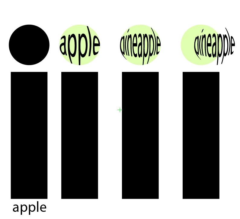

I'll make up a test example to post so you can see what I mean. Pretend I'm making a lowercase letter "i" as a graphic and wanted to fill the dot on top with the word apple. Doesn't matter how I make the "i" (using pen tool, shapes, text I turn to outlines, whatever), I have the dot. I just added a second green one behind it so the outer shape of the envelope is more visible.
If I use make with top object on the word apple like in the first instance, it does what I want.  If I do the same with a longer word like pineapple, it still does what I want like in the second instance.
But if I already made the envelope using apple and decide later to edit contents to change it to pineapple, it doesn't stay within the bounds of the shape like in the last instance, which is a problem if the point is for the word to be part of a larger shape (in this case, being the dot on the i).
After messing with it, it seems it will only do what I want if the type originally used for the envelope was centered, which I didn't see mentioned in any video or article I found when I was trying to figure out why my text kept shifting.
It even said in the adobe support page I read that "When you modify the contents of an envelope, the envelope shifts to recenter the results with the original content", which makes it sound like your change should reconfigure itself to match back up with where the original shape was but mine clearly wasn't doing that.
Is this the normal behavior that the starting text should be centered? Thanks!
