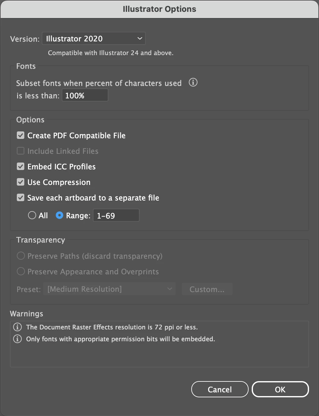

To export artboards in CMYK vector format, you can Save as Illustrator format and then check the box 'Save each artboard to a separate file'. This will produce .ai files with the main file name followed by the artboard name. Then you can batch rename using MacOS Finder and rename them to .pdf if you wish (the files will contain the .ai and .pdf content).
