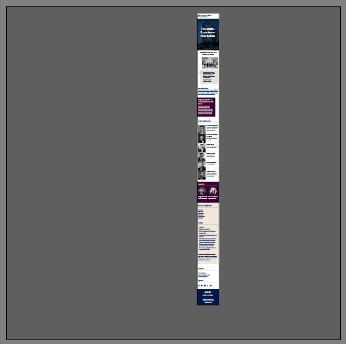

Hi people!
I am doing a mockup of a PDF Presentation for mobile. Here is the image. It is a regular size for a short landing page, nothing extrordinary really...
The artboard size is 1080 px wide for 14,000 px long. I read in some post that the very maximum exporting size of an artboard as PNG or PDF is 5050 milimiters (or 14,300 pixels).  Is there any way... script, third party software or app that i could extend this Artboard or the general WorkSpace? I need an extra 1000 pixels to add a photo.
I suppose i could reduce 50% everything but is it not the same as working in the right resolution.
Thanks for any help or ideas, i am really stuck with this issue.
Best,

Mylenium
August 18, 2022
You can try to extend the canvas in Acrobat once you have generated your PDF and then paste in that extra image at the end. Overall the whole approach sounds weird, though. Why not simply build this in Animate or an online simulation tool? such a large PDF may not even load on soem devices...

SebastiaoV
August 18, 2022
Thanks for the tip 🙂
The PDF is a presentation for mobile. Mabye Adobe XD is easier. I never worked on Animate and i needed to send this sample fast so no time to learn a new software but it keep it in mind for the future. It was good to work in Illustrator because it is static and i could later print some part if i need it.
I just solved it making two large Artboards and merging the PDF afterward. It not perfect because there is a small gap but it is a solucion i guess, haha.
