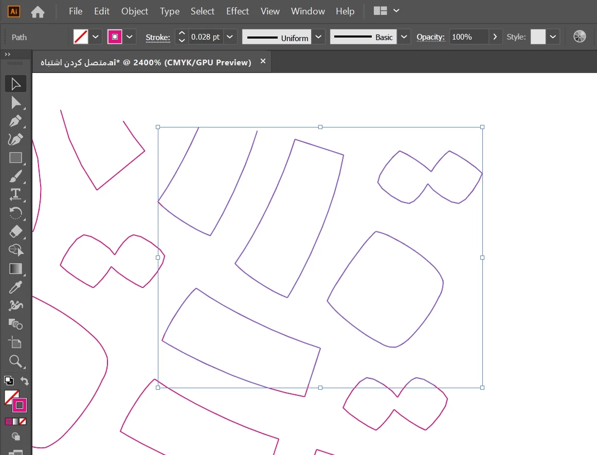

Hello.
I am using the Solid Edge 2D Nesting program to nesting shapes for the laser cutting machine. But when I use that nested file in illustrator I came to realize which all of my connected paths became separated from each other.
And that is a bad thing: because the laser machine use joined paths not separated. And as I know (and I wish I am wrong) Illustrator can not join path without the problem of joining unrelated paths together too! (Image bellow:)

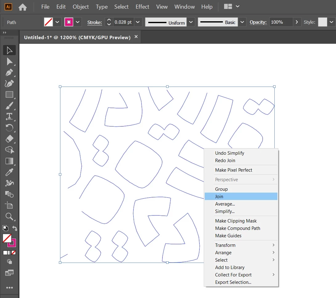

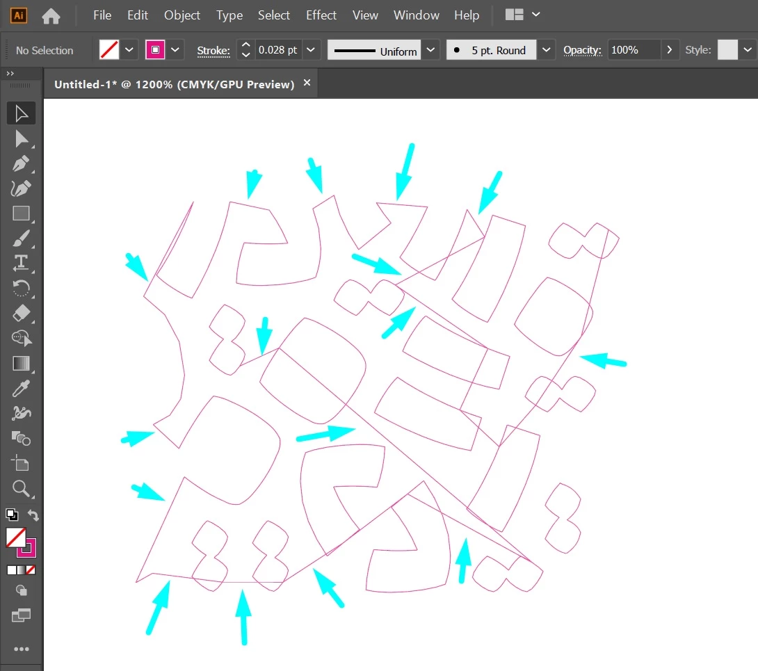

After using the join tool:
You can see unrelated shapes will become connected t each other too! and I do not want that.

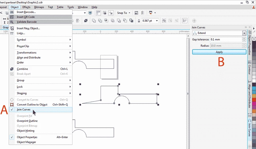

As I know CorelDraw has a solution to that and that is the "Gap Tolerance" feature (Like the image below) :
This feature empowering us to do not connect shapes with larger gaps between them. And separated shapes do not connect together (As I wanted to).

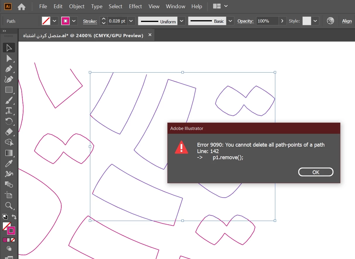

I've not tried it myself, but you could try Hiroyuki Sato's script "Join Reasonably".  It has variables you could set:
http://shspage.com/aijs/en/#join_reasonably
imtishAuthor
August 19, 2020
Thank you for that script.

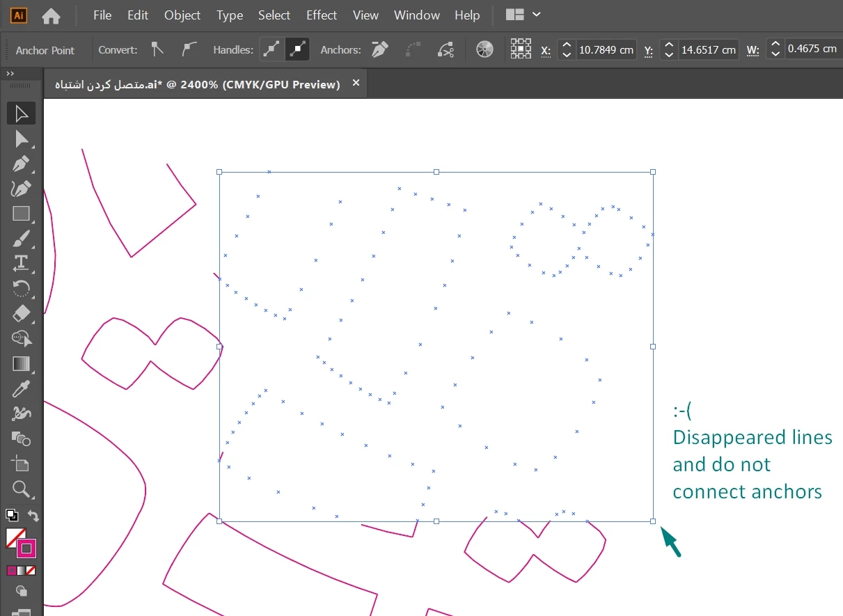

this was the result of that script:
Error is telling me:
Error9090: You cannot delete all path-points of a path
Line: 142
-> p1.remove();
