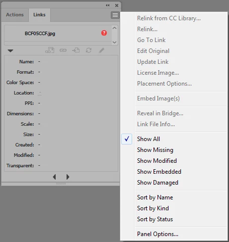

I'm converting a stack of .eps files to .svg as we move to a different publishing environment. Normally it's only Illustrator's insistence on replacing Arial with ArialMT that requires an extra pass outside Illustrator, but this morning I've hit something new: .jpg files included in the original .eps. I can delete the reference in the .svg version, but I want to locate them in the original .eps so I can check whether they even need to be there. You know what other people's .eps is like ;-}

Progress! Window > Links brings up a dialogue that does almost everything I need … except for letting me delete the linked items.
But persistence pays off. Click on the red-background ? to select an individual link, select Go to link from the three-bar menu, and a marquee appears in the Illustrator drawing. Press Del … job done. It could have been easier, though.

Hm – I'll check that, though I may have trouble installing plug-ins in a fairly paranoid corporate environment. In the meantime, at least I've worked out the source of the problem: whoever made these pictures of product box labels found some barcode samples somewhere, and every time I save an .eps file as .svg a new .jpg is created for each barcode. Very strange! especially as deleting the .jpg files makes no visible difference to the .svg files. When I've made my own labels recently I've used a free site that generates barcodes as .svg – no problem there ;-}
