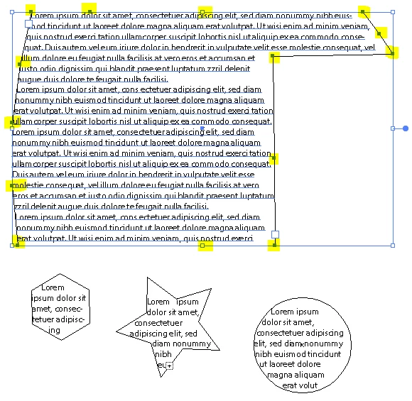

Hi ,
I need to get all join point value in custom area text (textframe) using extendscript?.
i try this,
app.activeDocument.selection[0].geometricBounds;
it returns
69.1558441558445,-109.363636363636,586.038961038961,-426.246753246753
Please help.

Hi RobOctopus,
Thanks for your reply, it returns only 4 points not for all.
529.357142848246,-561.500000000002
463.303571424123,-626.107142857143
397.25,-561.500000000002
463.303571424123,-496.892857142859
I attached my ai file here for your reference.
