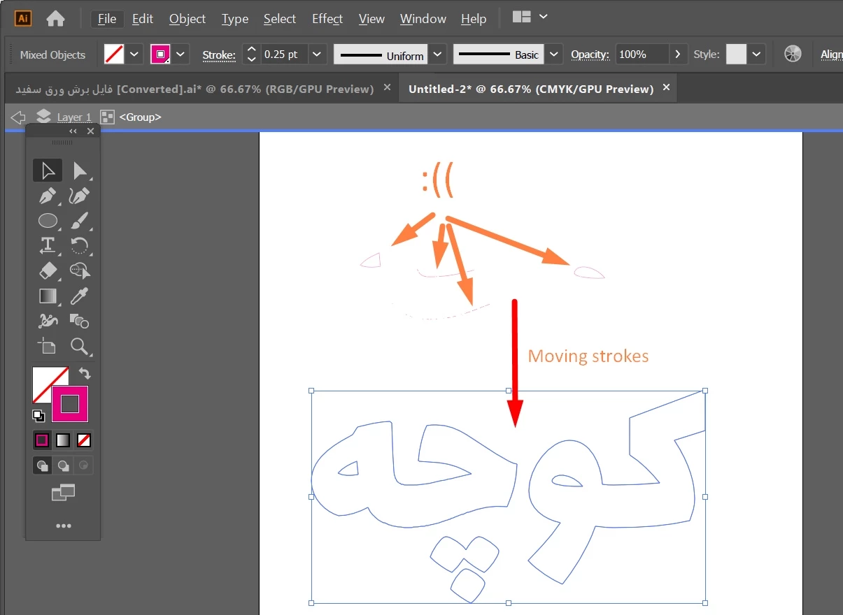

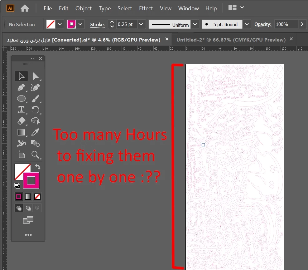

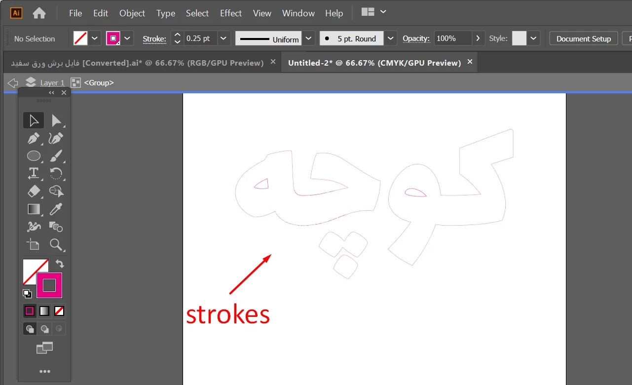

I am using Illustrator for design cut files in cutter plotter. The machine uses 'Strokes' for cut lines. So if we have several strokes on top of each one, this machine will cut twice because of those extra strokes.
My design is a huge file. How can we do not edit those extra strokes one by one (and fix those lines all at once)? Or in other words, can we merge strokes underneath of each other into one stroke? Or Can we somehow delete strokes that are behind to fix the issue? 
