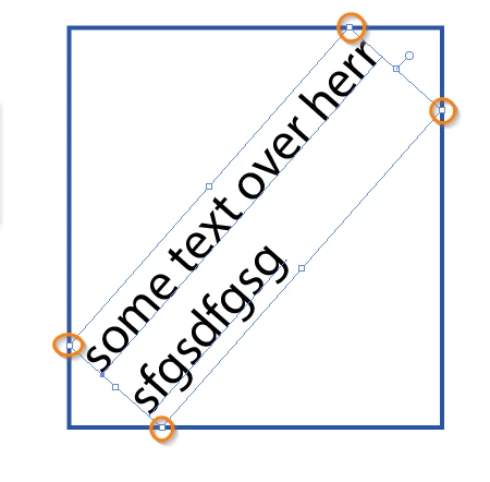

Hi all,
Yes I know that textFrameItems don't have pathPoints but..
How can I get the x, y coordinates of the corner points of a rotated textFrameItem.
I know that I can get the angle of rotation by asin(myTextFrameItem.matrix.mValueA) etc.
My guess would be that one should be able to use the mValueTX and mValueTY to help but those values are very confusing and change dramatically on applying even a small rotation.
If anyone has some ideas preferably mathematically based and not API base please let me know.
It is very late by me now and I suspect I must be missing the obvious, I would think such a function must of been made.
Thanks
Trevor
P.s. A solution to the same problem in InDesign would also be appreciated

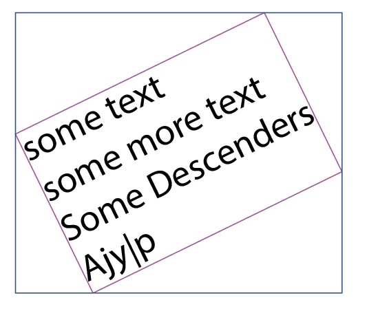

These are the results of the script

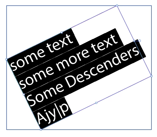

I majorly forgot to mention that the above script is for the point type of text frames.
For line or area frames one would use the textPath property which contains the pathPoints
CarlosCanto
June 23, 2015
mathematically, we'll run into the same issues as if the text frame was un-rotated (ascenders, descenders).
with DOM calls, I would duplicate the text Frame, convert to Area Text, get the textPath, then its Anchor Points.
...I have not tried this.
