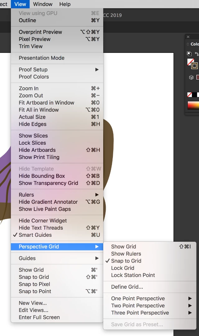

    BeanFactory
    November 7, 2018
    There are a few other things that affect snapping besides just the snapping menu. Go to view>perspective grid and see if snapping is turned on there too. Turning it off can help:
