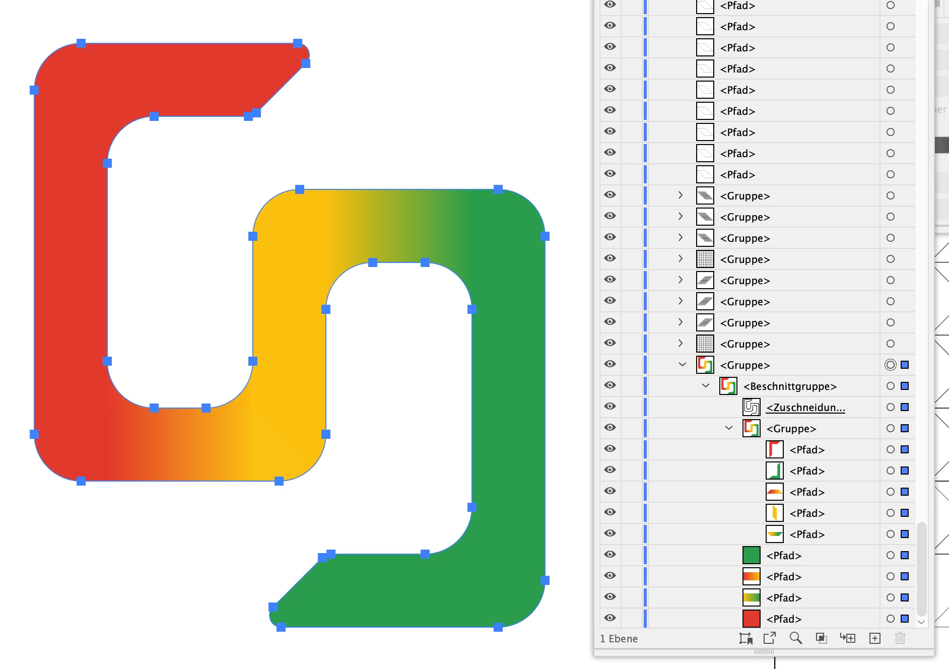

I would like to increase the thickness of the logo (image 1) like in the second image which I got chat GPT to render, although maybe not quite as thick - what is the easiest way to achieve this?
I created the attached shape (image 1) using a grid split into triangles, The logo is made up of multiple different shapes - red section, green section, yellow section, red-yellow gradient section, yellow-green gradient section, I also had to add gradient rectangles in the negative space within the logo after making the corners curved so that they inner curves would capture the gradient in a clipping mask.

Basically your problem is that this is not a single shape, but multiple. And there are clipping masks. So first of all you will need to combine them into one shape. Then you need to re-do the gradient, since that will get lost in the process.
Combining is simple: select the thing and in the Pathfinder panel first hit Crop in the bottom row, then hit unite in the top row.

the below attachment shows the build up of my shape after attempting to use offset path - the second image I posted initially was just a chat gpt render to show roughly what im trying to achieve.

I tried this but still getting stuck - when I use offset path it throws off the gradient, and also just creates an outline rather than expanding the shape - am I doing something wrong? See below images for clarity.

Can you please share the AI file?
