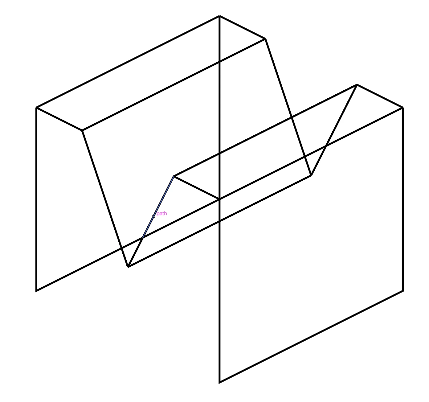

What do you do when you don't want to have closed paths like witbh the circle of the balloon. Here... let me show you...

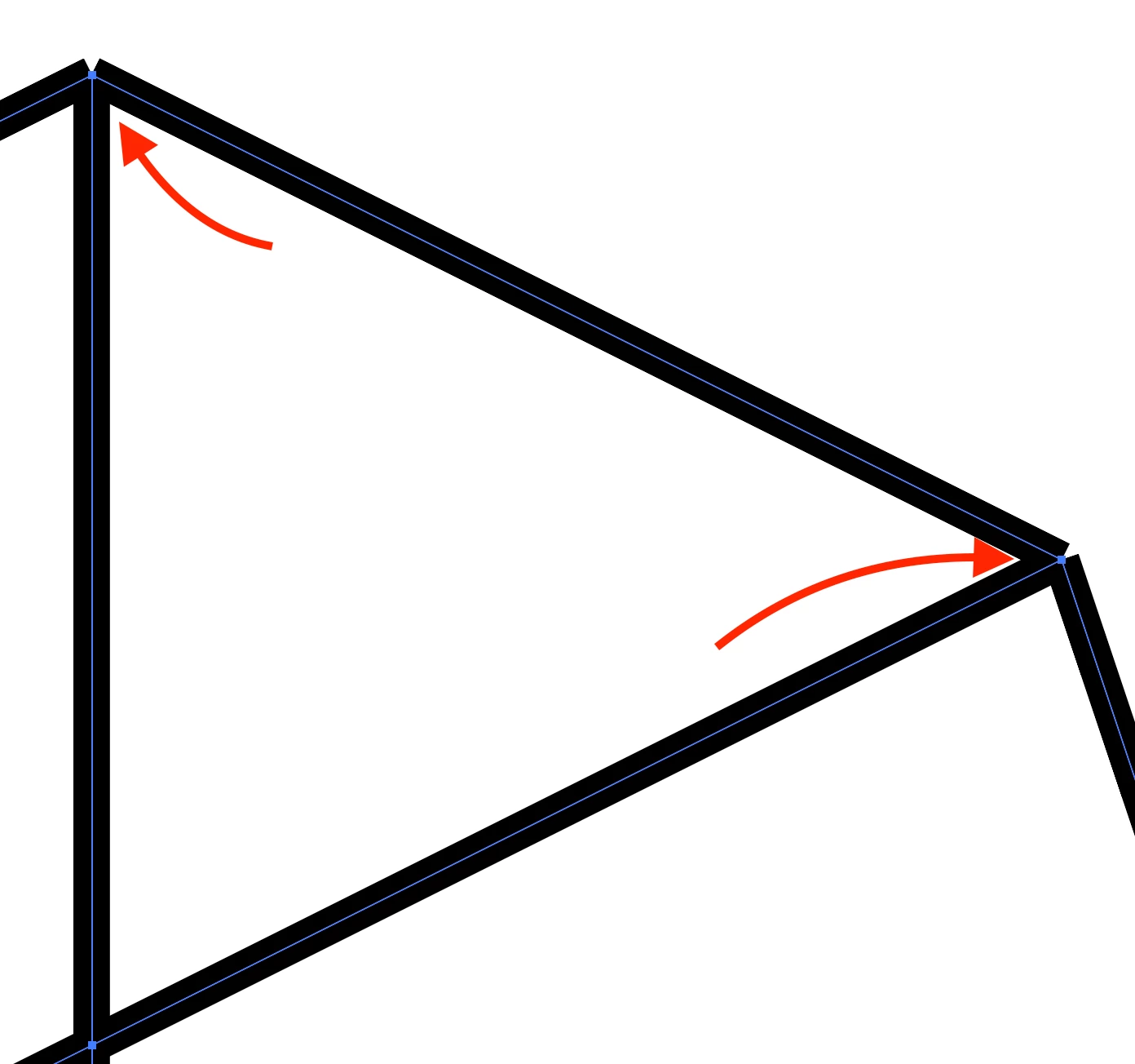

This is a line drawing that if you zoom in, you can see that it is a bunch of individual paths that intersect, but do not form any "fillable" objects. Here is a close up...
I would like to connect everything... so that each intersection does not have this obvious "buncha intersecting paths" appearance. I've been playing around with the pathfinder, but I cannot figure out a way to make all these paths appear "joined."
