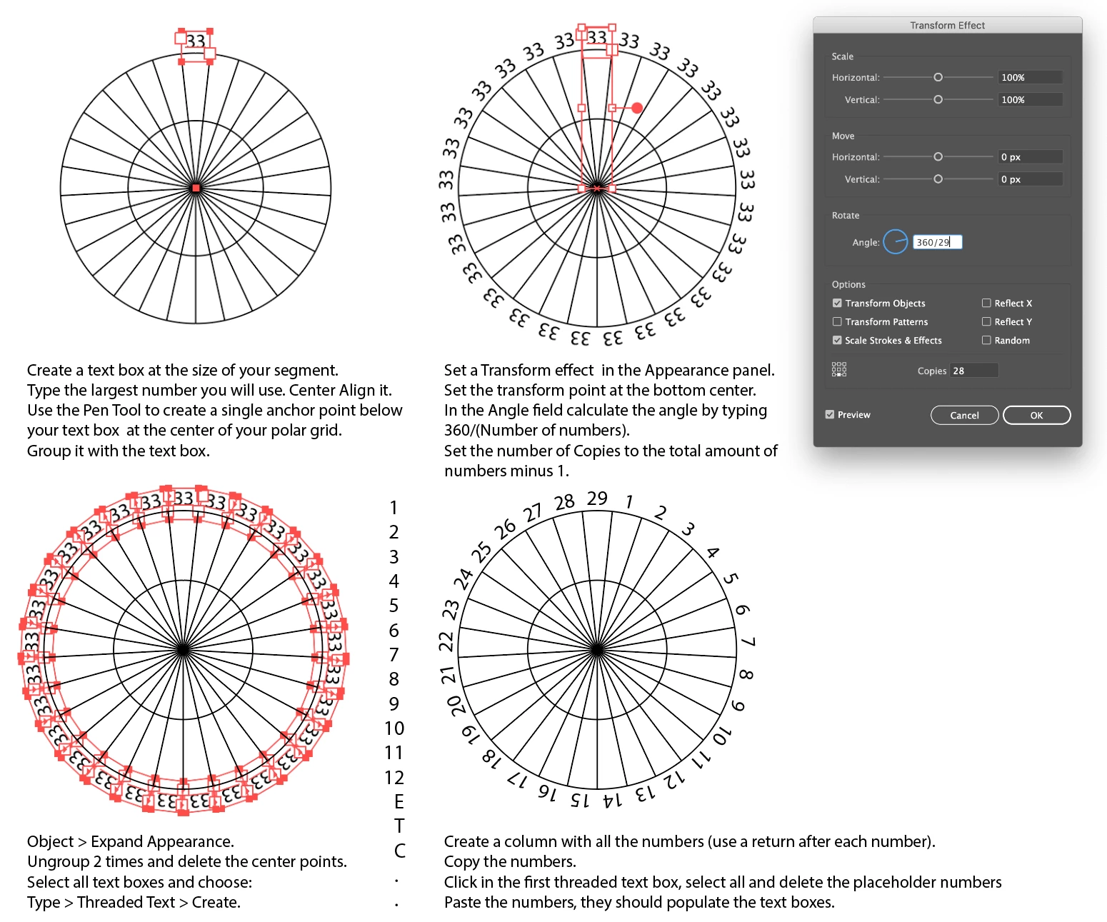

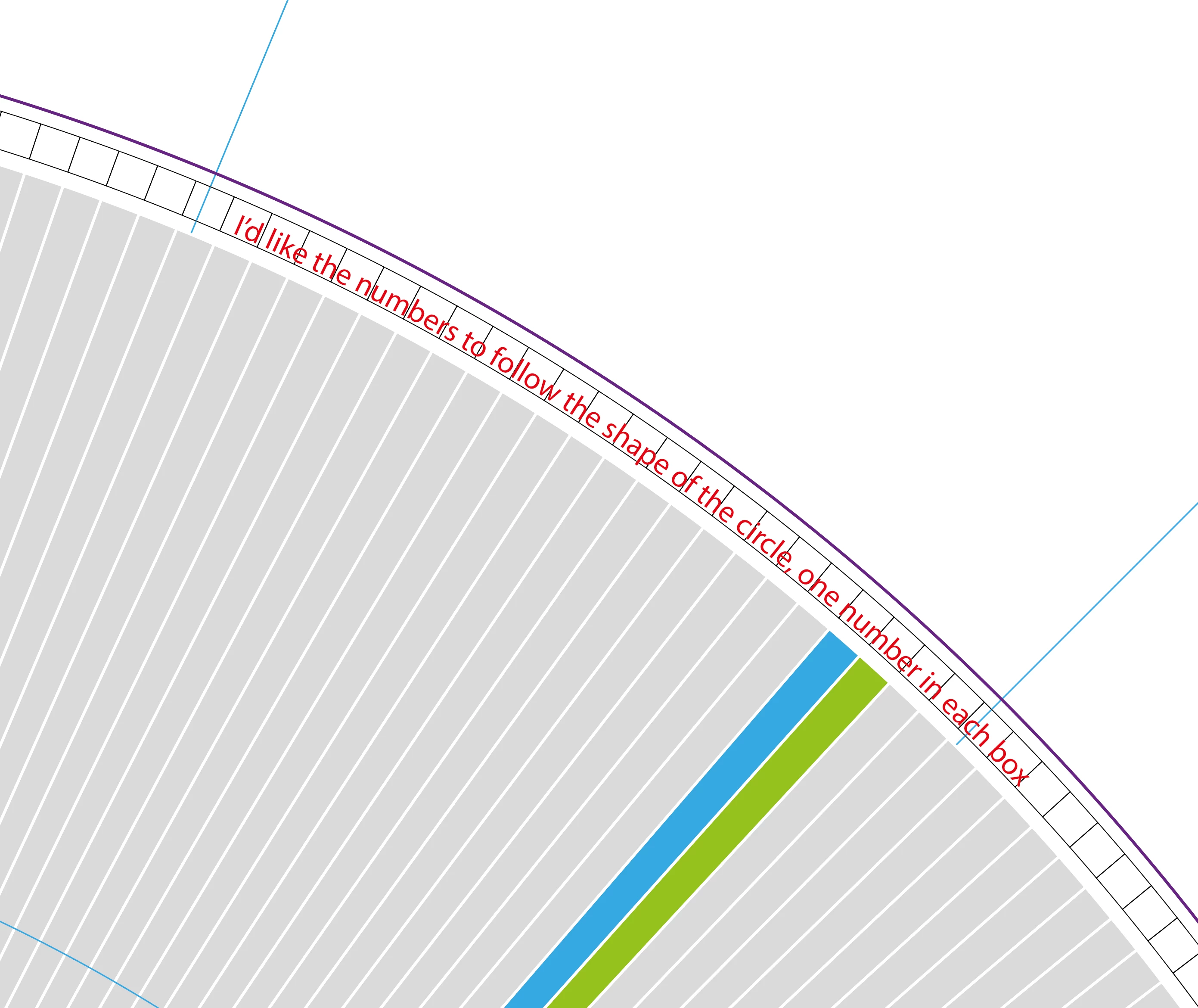

How to label each section of a polar grid with type on a path tool?
I have a polar grid with 366 radial sections. I'd like to label each radial section with a 1 or 2 digit number sitting on the end of the radial line (aligned to exterior circle of the polar grid, but i'm not sure what the best way is to do this. I've tried the area type tool within little boxes at the end of each radial section, but it orients the type horizontally, and i've tried the type on a path tool on a circle that is the same diameter as my polar grid, but then i can't space the numbers precisely so they perfectly align with each narrow radial section. Is there an appropriate solution? Thank you very much
