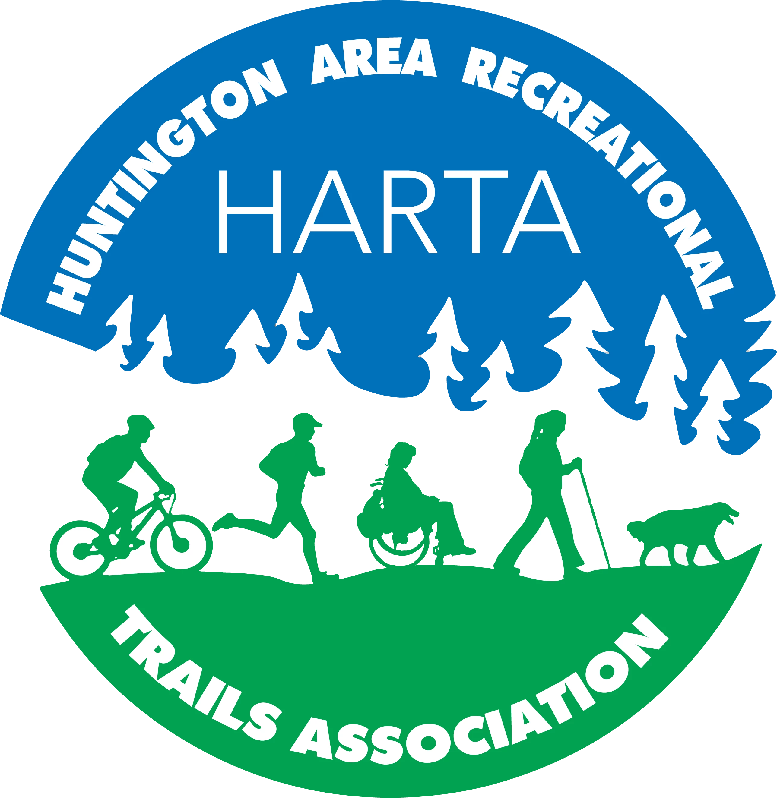

How to make a fill over a transparent area while matching the existing artwork.
  • March 4, 2024
  • 403 views
What is the best way to make a white fill in the transparent area? I've tried using the elipse tool to put a white circle behind the entire design and I cannot get the edges to line up.
Correct answer Jacob Bugge
Eric,
Unfortunately, the image fails to show the top and bottom.
Are you sure that the blue and green outer boundaries form part of a/one and the same circle?
You can (also) establish the total height, then create the white circle with that W = H, move it behind, and Align it with the existing artwork; and if it fails to have its boudary flush with the blue/green parts, you can adapt the boundaries of the latter (or the boundaries of the white circle if you must).

Here is the full image, i wanted to show the transparent area.  I was able to adjust the elipse to make it fit, was adjusting by hundreds of an inch.
Ton Frederiks
March 4, 2024
Draw guides that snap to the 4 sides.
Use Smart Guides to (Cmd/Ctrl U  to toggle them on/off).
Drag an Elipse from the top left guides intersection to bottom right.
