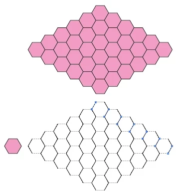

    Steve Fairbairn
    March 25, 2011
    I presume you mean hexagons. Try this:
    Make a repeat pattern of hexagons. Easy with copy/drag and Cmd+D. Shown pink below.
    Copy it and Cmd+5 (make guides).
    Select one side of an original hexagon, copy, paste and snap to guide.
    Copy drag to next guide etc. etc. Group
    Repeat same procedure for the next side.
    And again for the 3rd side.
    Best use round caps so that the corners meet properly. You will be able to join some of them if you like, but obviously not all of them.
    Here's an example. I have drawn 2 sets of sides.
    You can also do much of this with the pen tool snapping to a hexagon grid guide. I'm not sure which way is quicker.
