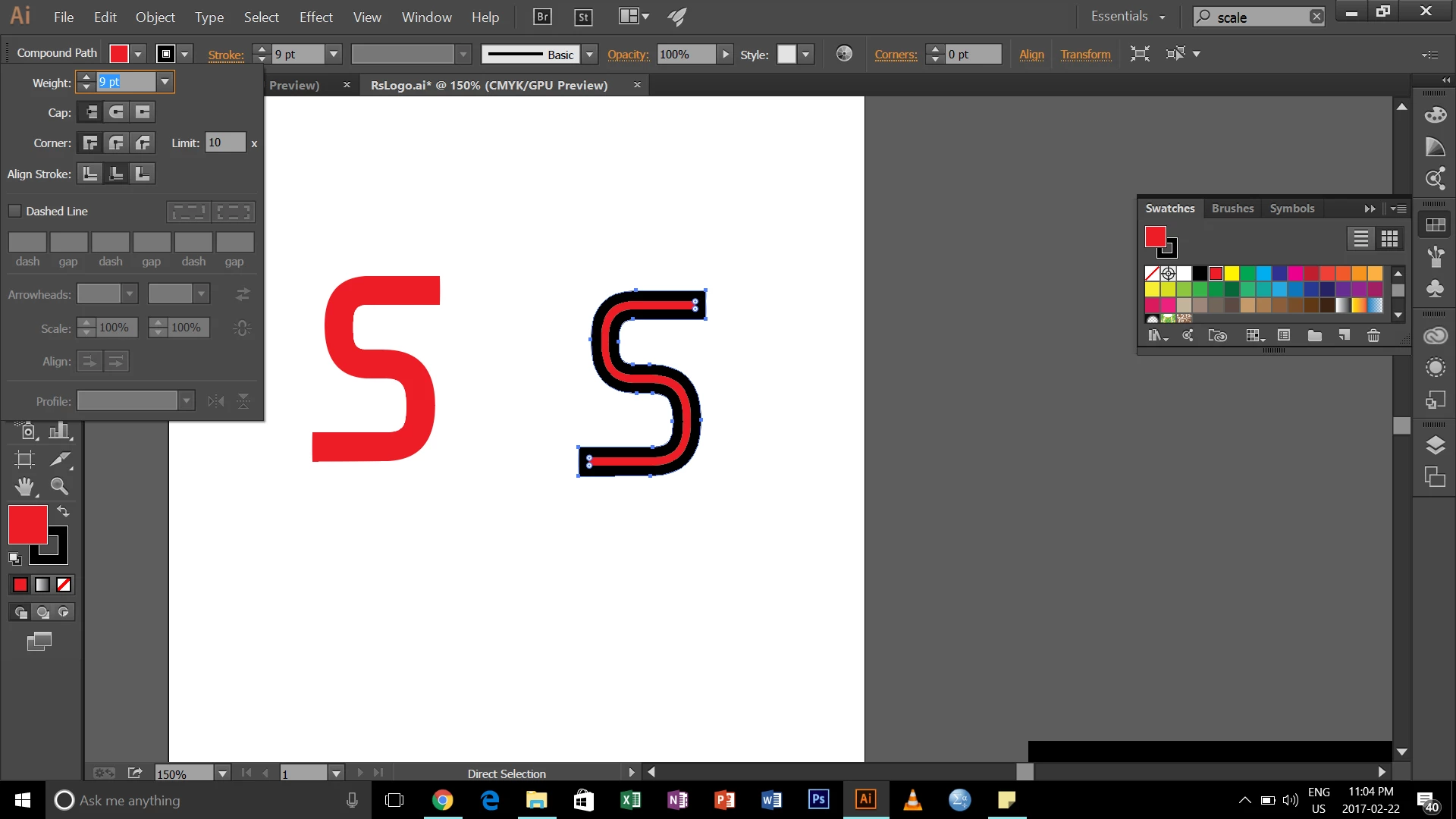

How to make front thinner (stroke thinner than 0)
I'm trying to make my "s" as thin as it is in the red section is on the "s" on the right side, the "s" on the left side is still very thick with a stroke of 0. i have tried creating a stroke on the inside like i have on the right "s" but i can't seem to just get it with the red section and not the black stroke on the outside. In other words i want the red "s" as thin as the red "s" is within the black portion.

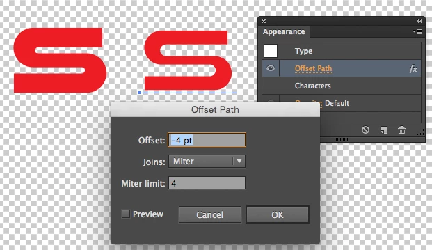

    Effect >> Path >> Offset Path works on both live text and vector paths.

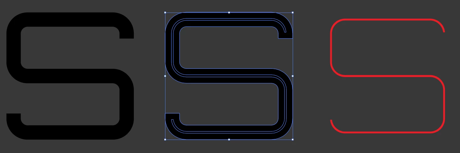

    If you wish to avoid shortening of the lettershapes by the same amount as the thinning, and especiallly if you can use a stroked path for the final shape, you may (save artwork before starting and maybe on the way), it is especially easy for letters like S and C and I:
    1) Ctrl/Cmd+Shift+O to create outlines, then Ctrl/Cmd+Shift+G and Ctrl+Alt+Shift+8/Cmd+Option+Shift+8 to get individual paths, switch from Fill to Stroke and set the Stroke as desired;
    2) Object>Blend>Blend Options, setting Specified Steps to 1;
    For each letter:
    3) With the Direct Selection Tool click and delete end segments if relevant (letters like the S); for certain letters you will have to do some more to work with letter parts (letters like A and B);
    4) Select the two paths and Ctrl+Alt+B/Cmd+Option+B.

    You could also if the S is already outlined go to Object>Path>Offset Path...
    Then select preview and set the offset to minus whatever number works.
    You will start with the first S and then after adding a minus offset you will see something like the second S then if you then delete the outer path you will end up with the last S...
