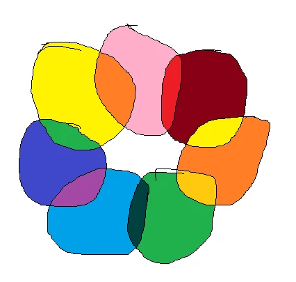

For a print, I need to convert our logo to one color. The current logo is seven shapes that overlap. Each shape is semi-transparent. This means that when you view the logo, it's made up of lots of colors where the shapes are overlapping each other. Attached is an example which looks nothing like the logo. But it shows that there are 7 shapes which intersect each other.

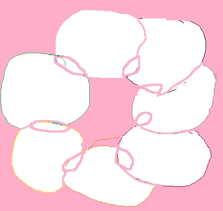

For the one-color print job, what I've done is convert each shape to white. Kinda boring. So I want to set it up so that the borders which intersect are "cut out" (AKA transparent). This way the logo will maintain its unique design with each smaller overlapping area being preserved. It's all in white though. Does this make sense?
There are no strokes on the shapes. They're laid out precisely with no overlap, so even if they had strokes, deleting the stroke wouldn't give me the result I seek. I've also tried selecting all seven shapes, grouping them, and then using all the pathfinder tools to achieve the result. All I get is the whole thing disappearing except a small portion. So I then tried only selecting two shapes and then using all the pathfinder options. Nothing. The logo is all on one-layer.
Any other suggestions? This is driving me absolutely batty.

No it doesn't make a 100% sense to me I'm afraid..
Also its hard to understand when we only have a rough drawing and your saying conflicting statements...
You say that you want to delete the intersecting areas but at the same time you say that they have no overlap? - Then how can they intersect?
Can you show a better example of what you want to achieve roughly and what the problem is?
Logically you would want to use Pathfinder divide with all the layers actively selected to get the result you want and then simply ungroup and delete the intersecting areas > then re-group.
Have you tried getting rid of any transparency or other effects, and either using a one colour fill/stroke (Either OR not both) before trying to use pathfinder options?

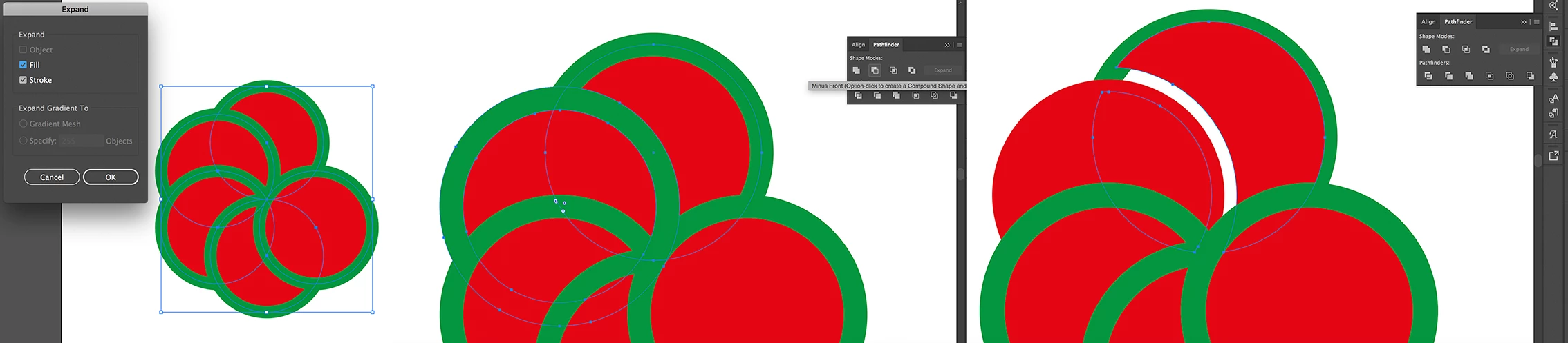

Try this workaround:
1. Add a stroke on each shape
2. Expand all objects (keep fill and stroke checked)
3. Ungroup all objects
4. Select the stroke of above object and the below object
5. Use pathfinder > Minus front
6. Repeat the last two steps for other objects
7. Delete unnecessary parts
Possibly, reassemble the shapes using pathfinder
Alternatively, you can use the Live Paint Bucket (after expanding the objects) on the stroke portions to apply none swatch.
72732799Author
February 6, 2017
Thank you for your help. When I ungroup the items, I lose the new color areas which are only visible because the layers are semi-transparent. I.e. blue and yellow circles' overlap is green. Now that green area is just blue. Thanks to the way the seven shapes overlap, there are about 20 inner areas which are only visible thanks to the transparent overlapping.
