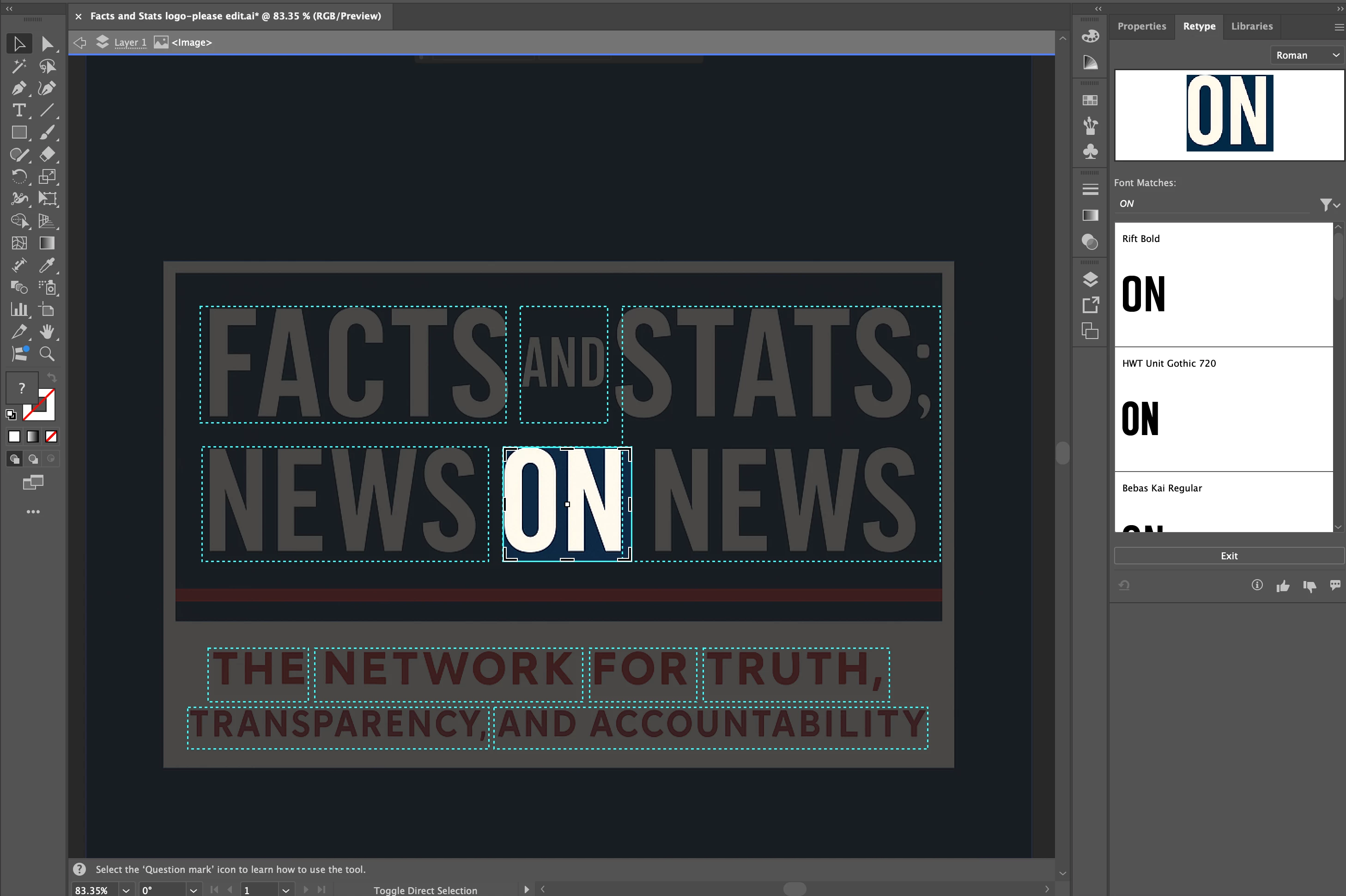

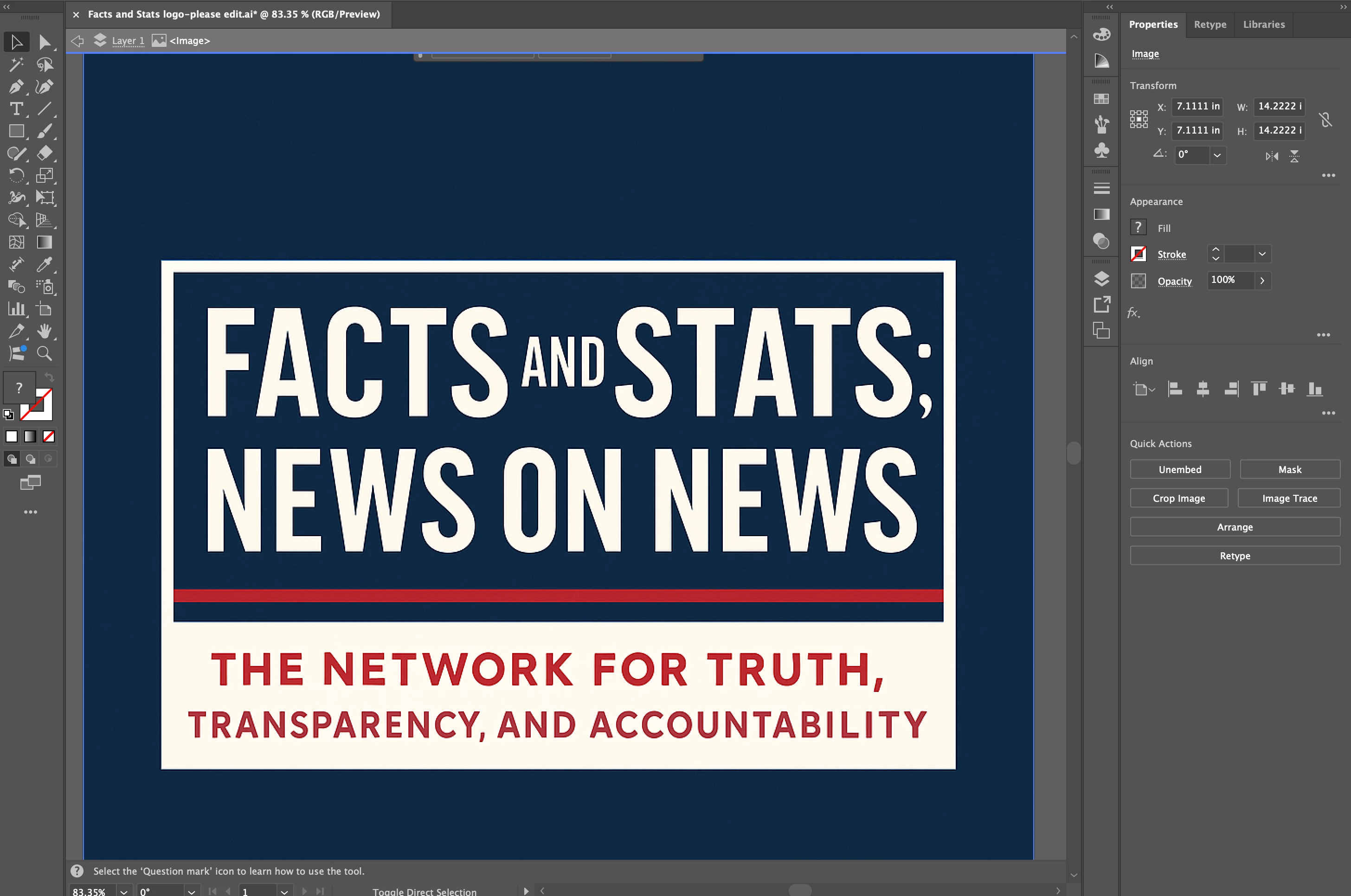

Does the pic below tell you?
I tried the RETYPE tab, but that didn't allow me to edit text; it still sees it as an object.

It's a raster image. You cannot edit text in a raster image. This is also not the sort of thing that Retype would have solved reliably.
You need the vector source file.
