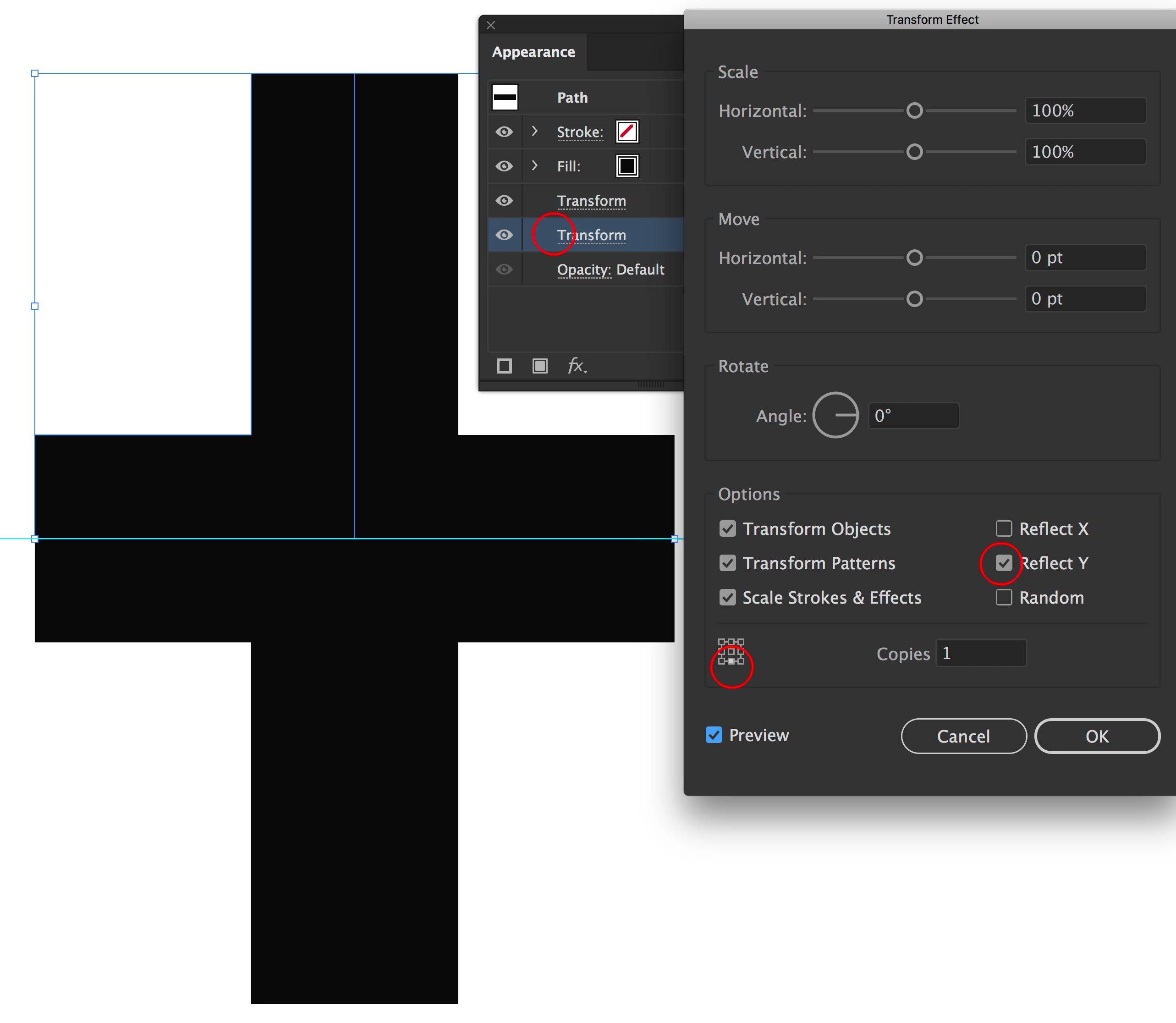

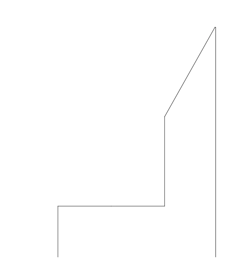

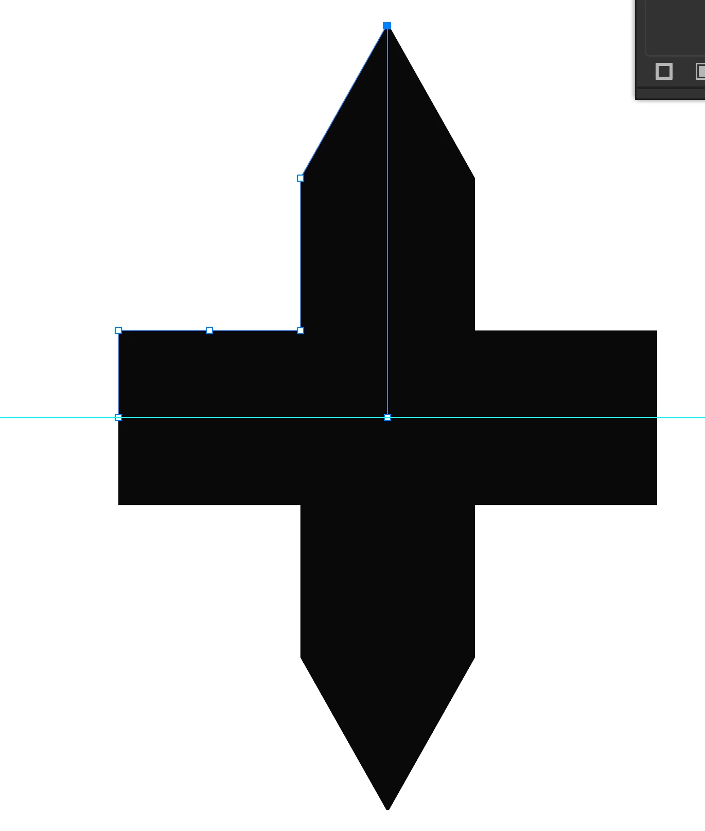

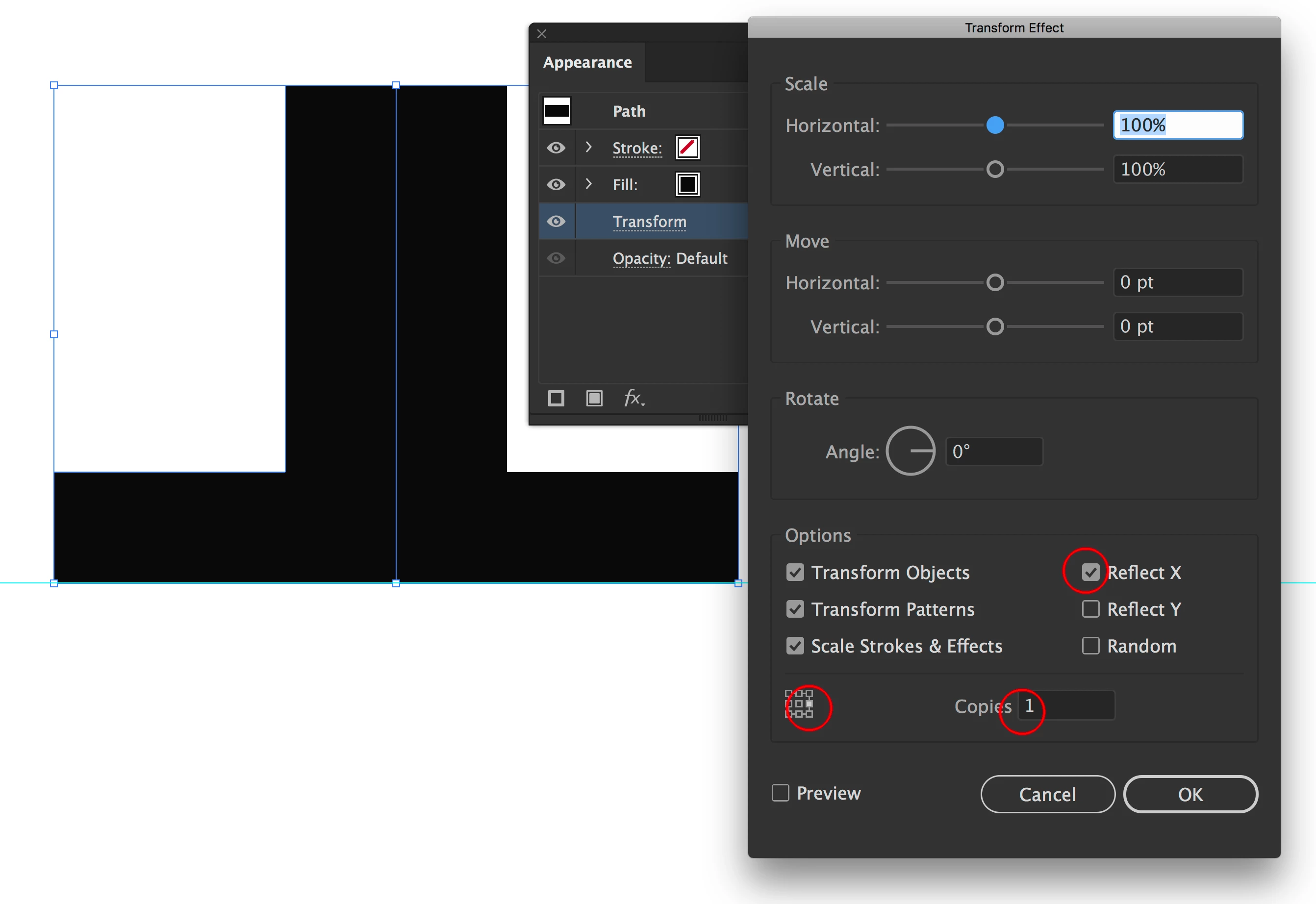

    Another way to do thsi is by making a tessalaltion if you are familiar with MC Escher.
    Reduce your cross to 1/4 of. the shape using add anchor point adn deltreing points.  Effect >> transform
