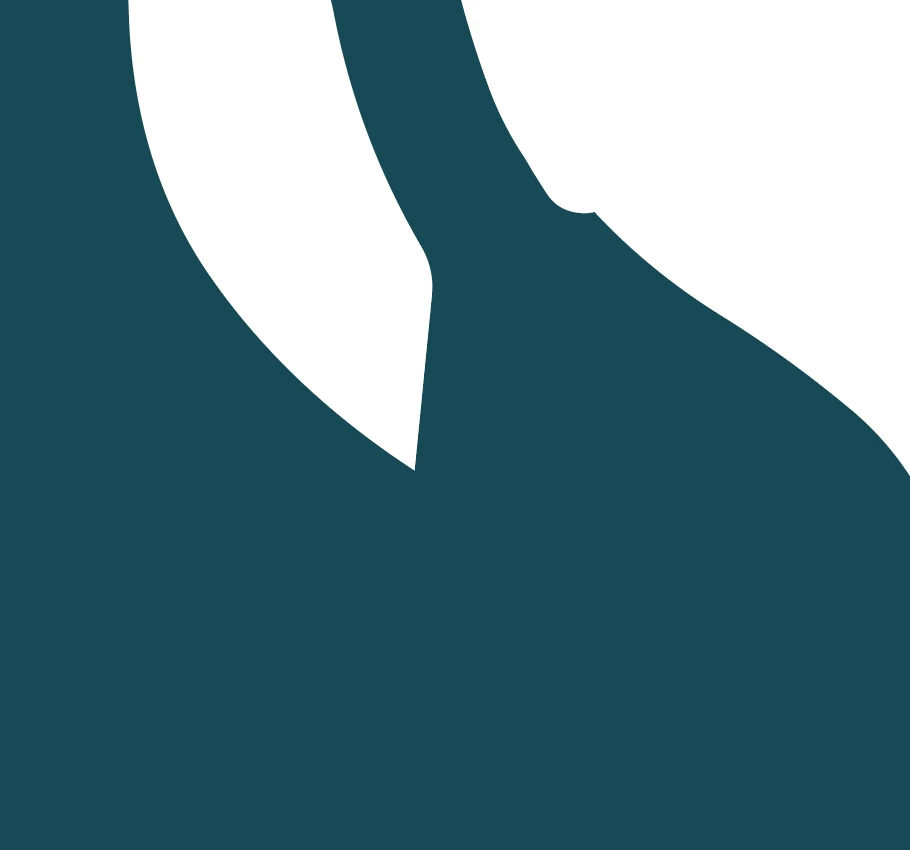

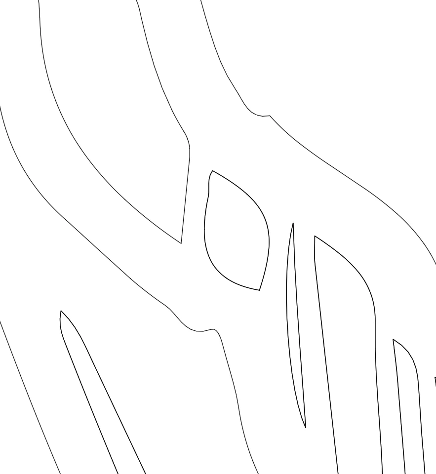

Hi there, I found an illustration of a plant and before completing I made it a compound path. After this I gave it a fill colour. What happen when making a compound path of the illustration, is that an extra copy of inside path/s is made which should allow it to be transparent. This fills up so this path (inside) shows up filled even though you made it compound.
I can delete the path and then in attributes (Reverse Path Direction On or Off) to make the inside of the path transparent. However, if you have a detailed illustration it’s very labourious. Is there a quick way to remove the extra path/s without individually removing them one by one? Please let me know. Thank you

Or use the Lasso tool to select a few of the points from the shapes you want deleted and press the delete key twice.
Edit:
Release compound path > send outer shape to back > select all shapes > r-click - create compound path.

Alan,
As I (mis)understand it, you can:
1) Release the Compound Path,
2) Pathfinder>Minus front/Subtract from shape area.
2) is a/the failsafe way of creating a Compound Path with holes.

If you want a hole in your shape, then you need a compound path.
Deleting the paths will make the holes vanish. Is that what you want?
In that case you could release the compound path via Object > Compound path > Release and then unite the result with the Pathfinder Unite
