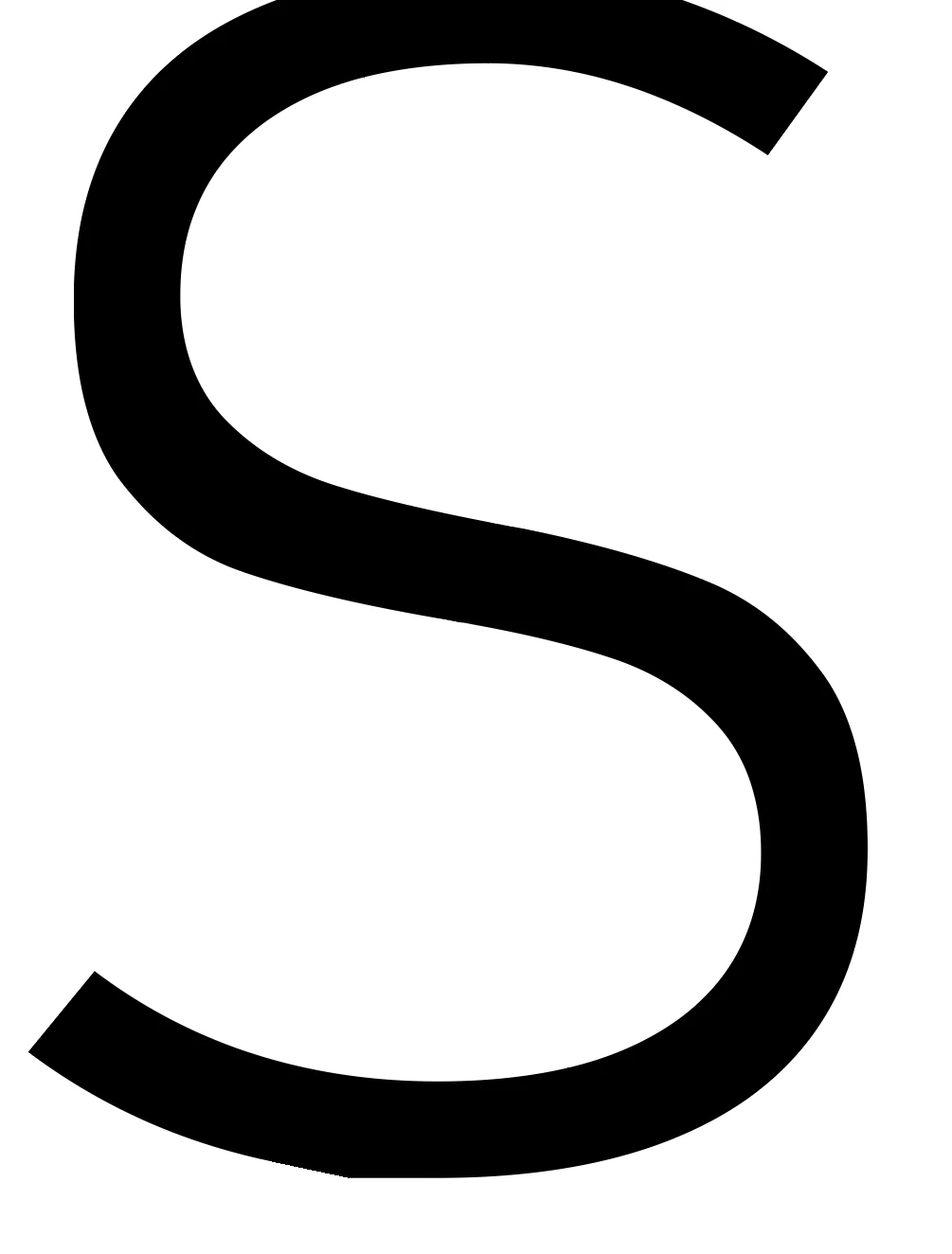

I am working on a logotype.

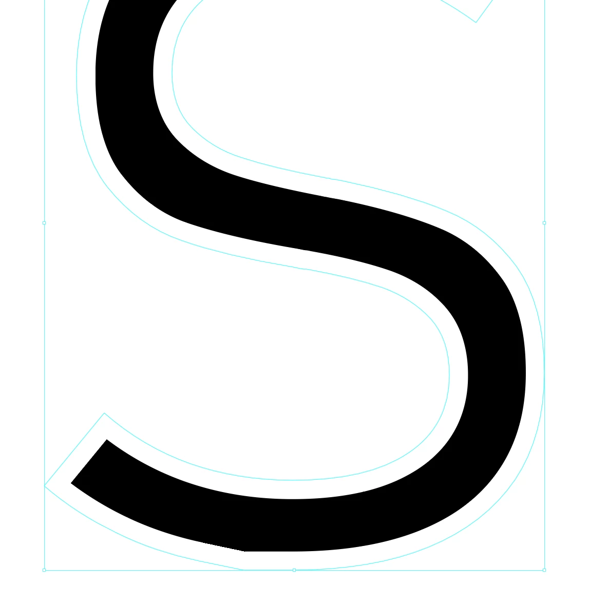

I have an s here for instance. I like the weight of the s and would like to keep it. However, I achieved the weight of the s by adding a thick white stroke.
Is there a way to keep the weight of the s (the weight of the black part), while eliminated the white stroke?
Thanks!
(s without stroke showing)
(s with white stroke highlighted)
    Correct answer ScooterD76
    Expand the object, then Merge, in the pathfinder. Use the direct select tool to select the white area and delete it.

    ScooterD76
    ScooterD76Correct answer
    August 10, 2018

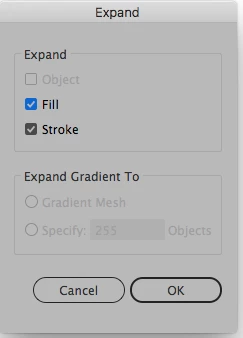

    August 16, 2018
    I was able to do it by expanding by going to the object drop down menu - expand - expand fill and stroke - and then just by deleting the parts I did not need with direction selection tool.
