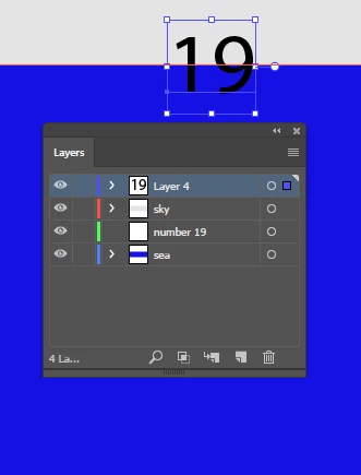

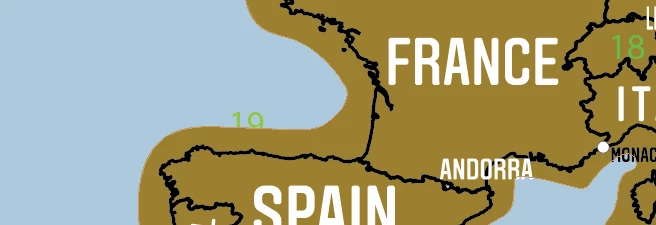

I am having a lot of trouble moving an object onto a layer. See in the below picture that the green 19 is stuck behind the gold layer on top of it.
Do you know what I have to do to move it on top of it?
Thanks in advance.

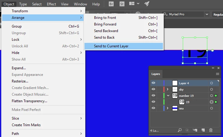

    January 28, 2017
    Tom,
    It may be enough to just select the 19 (just Click it with the Selection Tool), then Ctrl/Cmd+X+F; that is if it is in the same Layer as the golden map object(s).
    January 28, 2017
    Move an object to a different layer
    1. Window > Layers (F7),
    2. Create a New Layer
    3. Select the object. (number 19)
    4. Do one of the following:
    5. Click the name of the desired layer in the Layers panel. Then choose Object > Arrange > Send To Current Layer.
      Drag the selected-art indicator , located at the right of the layer in the Layers panel, to the layer you want.
    Barb Binder
    January 28, 2017
    If the gold map and the green 19 are on the same layer, select the green 19 and use Object > Arrange > Bring to Front.
    Otherwise, open Window > Layers, and drag the green 19 sublayer up above the map in the Layers panel.
