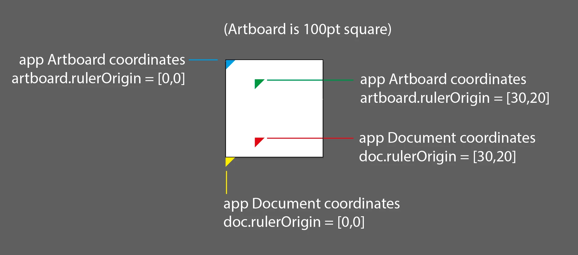

I get this result:
If you have a careful look at that you will see that artboard coordinates go from topleft [0,0] with positive Y down, but document coordinates go from bottom left [0,0] with positive Y up. Note that each time I have set the position of each triangle to [0,0], so the change in positions is solely due to coordinateSystem and rulerOrigin.
In your own scripts, my suggestion is—just as my script does here—to explicitly control both the app.coordinateSystem, and either the doc.rulerOrigin, or the artboard.rulerOrigin (depending on the coordinateSystem you choose). And don't forget to clean up afterwards!

I get this result:
