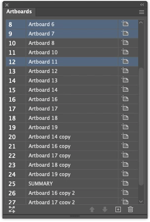

I would like to make a small script (.JSX) that print only selected artboards.
Artboards are selected directly from the open document and/ or vi the “Artboards” palette.

Multi-selection in the Artboards panel (Cmd+click to select rows 7 and 8 simultaneously, as in your screenshot) — this panel UI state has no corresponding DOM property. It is pure interface state, not reflected in the ExtendScript object model. Every expert source, the official JS reference, and the Illustrator Scripting Guide confirm the Artboard object has only: artboardRect, name, showCenter, showCrossHairs, showSafeAreas, rulerOrigin — no isSelected.
Is that true?

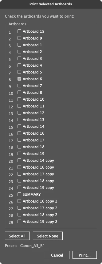

I really wish to selected the artboards directly from the open document and/or via the “Artboards” palette.
So the below approach isn’t what I’m looking for  ;-)

    Unfortunately, user selected artboards in the Artboards palette are not accessible via the API 😢. I’m sure there are some hacks on this forum to get what you need if you do some searching.
    One option would be selecting the items on the artboards you need (instead of selecting the artboard) and then looping through each artboard in the document to check if any of the selected items are within the `Artboard.artboardRect`. Definitely not a clean solution but you might be able to make it work and skip using that dialog you showed above.

    "Proceed to Print?",
    false,
    "Confirm Print"
    if (!confirmed_DC) return;
    firePrintDialog_DC(rangeStr_DC);
    // ─── KICK OFF ─────────────────────────────────────────────────────────────
    main_DC();
    // ─── RUN ──────────────────────────────────────────────────────────────────────
    runPrintSelectedArtboards_DC();
    jduncan
    jduncanCommunity ExpertCorrect answer
    March 19, 2026
