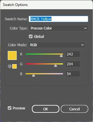

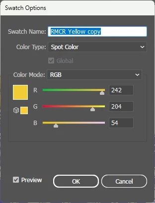

Thanks for the prompt reply.  I understand a spot color is a single mixed ink.  If a spot color is defined with the same values as a process color, should they not print the same?  The two swatches I've posted use the same color values R-242 G-204 and B-54.  Will these no print the same?
