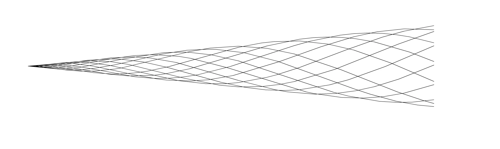

How to quickly draw such lines in Illustrator

Draw one of the waves, taper it with a warp, position it. Rinse repeat for every line. Then cut off the overlapping ends that you don't need.

Is there a specific tutorial

Draw a straight line
Use the zigzag effect to make waves
Use the transform effect to make copies
Expand appearance
Cut off the the front, so all lines begin at the same x location
Make an art brush out of it
Apply to a straight line
Apply a width profile to it that enlarges it at one side.
