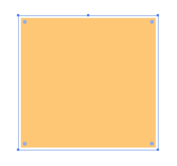

I have graphics generated by another program that creates 5 point squares -- four corners and one intermediate point on the upper line.  As below:
I would like to remove that center anchor point, so that distortion/transformations behave as I want.  "Simplify" seems to add curves, not quite what I want.  There are 1000s of these objects; so fixing by hand not really an optimal solution.  Any suggestions for automating this?

As I look closer at the object, seems in fact there are two stacked points at that center line (so 6 points in total, 1 at each corner and the two in the middle.   I've attached one for reference.   I'm not able to get the simplify to work on this (selecting straight lines & 90-degrees).

As long as your rectangles are unrotated (and ideally non-overlapping) you may just select them, go to the Pathfinder palette, use Pathfinder "Add" there (while the "Remove Redundant Points" option is turned on in the Pathfinder Options dialog (see flyout menu of the Pathfinder palette).

Simplify with option "straight lines" checked does not what you want?

Simplify seems to work, but when using straight lines, the Corner Point Angle Threshold needs to be set to 90 degrees.

It seems that turning on the straight lines option and setting the angle to 90 degrees remove the anchor point in the middle of a line, but introduces a new anchor point at a corner. Simplify without the straight lines option works fine.
