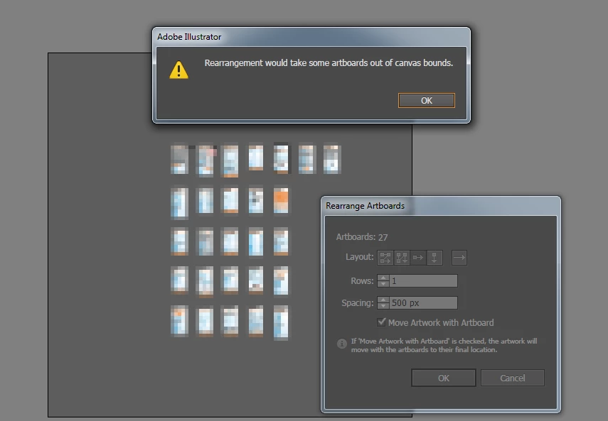

October 22, 2015
My friend created an page layout in AI. Lots of afartboards. Now when i edit this, i can't rearage ardboards, because they can't fit in canvas bounds.
aTomician
November 24, 2015
Did you manage to rearrange artboards? - if you are still struggling you can press Shift+O and move and resize the artboards individually.  Let me know if this isn't any good
