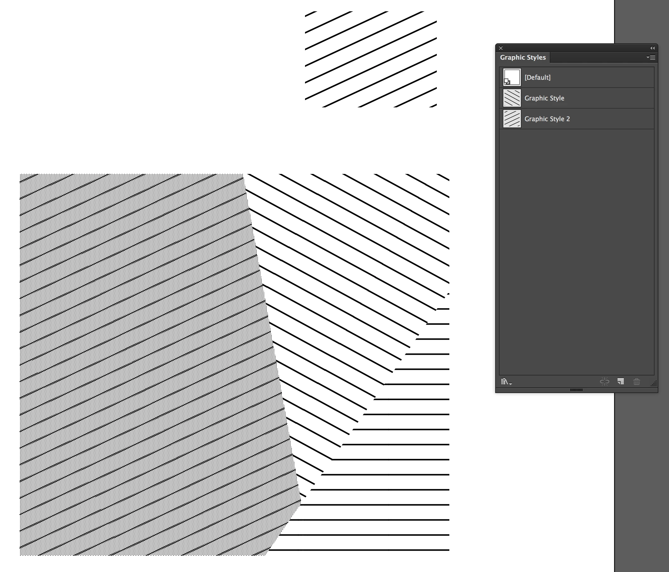

The only way I know of to control the pattern rotation in separate Live Paint shapes is to assign unique Graphic Styles to each shape. Fill a separate shape with the fill pattern and rotate ONLY the pattern, saving each rotation angle as a separate Graphic Style. Then assign the appropriate Style to each Live Paint shape.
