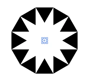

    Jacob Bugge
    Jacob BuggeCommunity ExpertCorrect answer
    May 19, 2018
    Chris,
    You have to make a choice to start with, and the most obvious one would be to choose the number, divisble by 4, presuming you already have diameter/radius of the circle, otherwise you willo have to choose that as well.
    After that you can, for an accurate solution without complicated calculations/adaptations/whatever:
    1) Create a polygon with the chosen number of triangles and the same radius as the circle (half the diameter); this will give you a polygon with one side at the top; lock it;
    2) With the Line Tool ClickDrag across the top side of the polygon from one Anchor Point to the other;
    3) Ctrl/Cmd+C+F to copy the line on top of itself, then:
    3a) If the triangles are to be outside the circle, in the Transform palette set the bottom left Reference Point and insert 60 degrees in the angle box and press Enter; this will give you the second side of the triangle;
    3a) If the triangles are to be inside the circle, in the Transform palette set the bottom right Reference Point and insert 60 degrees in the angle box and press Enter; this will give you the second side of the triangle;
    4) Select both 2) and 3) and Ctrl/Cmd+J to join them (you may ClickDrag across the coinciding Anchor Point with the Direct Selection Tool in older versions; then Ctrl/Cmd+J again to complete the triangle;
    5) Unlock the polygon, then:
    5a) If the triangles are to be outside the circle, create a large enough auxiliary circle and centre align it to the polygon, then Group the auxiliary circle and the triangle;
    5b) If the triangles are to be inside the circle, Group the polygon and the circle;
    6) Effect>Distort & Transform>Transform set the Rotation to 360/number of triangles and Copies to that number less 1;
    7) Object>Expand Appearance, the Ungroup and hide/delete the polygon and the auxiliary circle, if any.

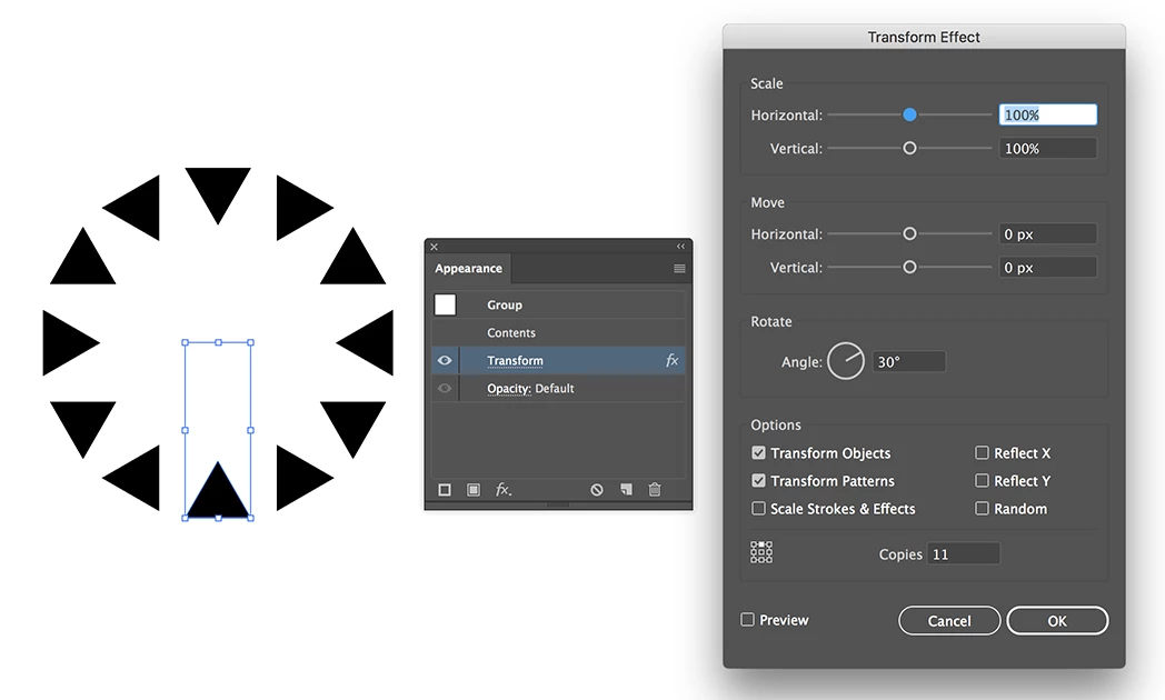

    Ton Frederiks
    May 19, 2018
    I would use the Transform effect and nudge the objects into place.
    Start with a triangle and put a single anchor (invisible) point above it.
    Group them.
    Use the Appearance panel Distort & Transform > Transform effect to create the number of copies at 10, 15 or 30  degrees.
    Click OK and use the Direct selection tool to select only the invisible anchor point.
    Nudge it up or down with the arrow keys until the triangles touch.
    Or scale the triangle until they touch.
