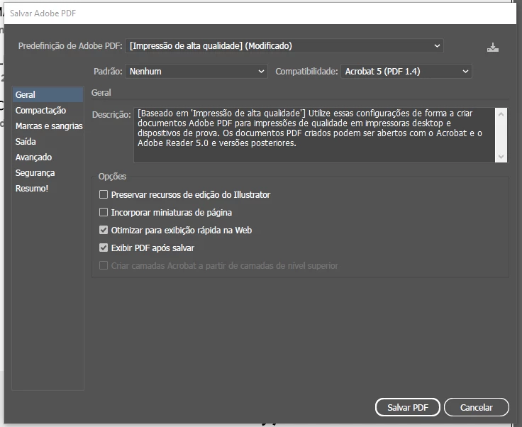

I create a resume (CV) with Illustrator 27.0 with some texts and images.
When I save in PDF I use this configuration:
The problem happens when I open this PDF file with Adobe Reader and try to copy some text.

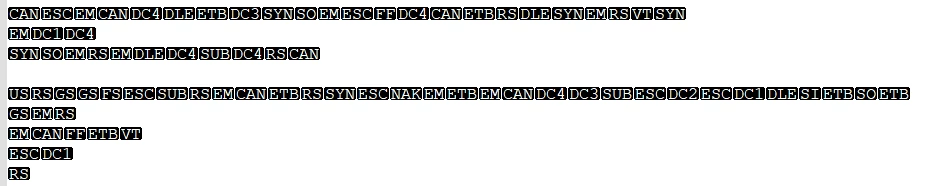

When I paste this text somewhere else, strange characters appear.

Can you give an example of the strange characters?
September 13, 2023
Characters like:
When I try to paste in Notepad++ the characters are:

Looks like the Source Sans Variable font is problematic.
The Source Sans Pro seems to work.
What happens if you don't use a variable font?
