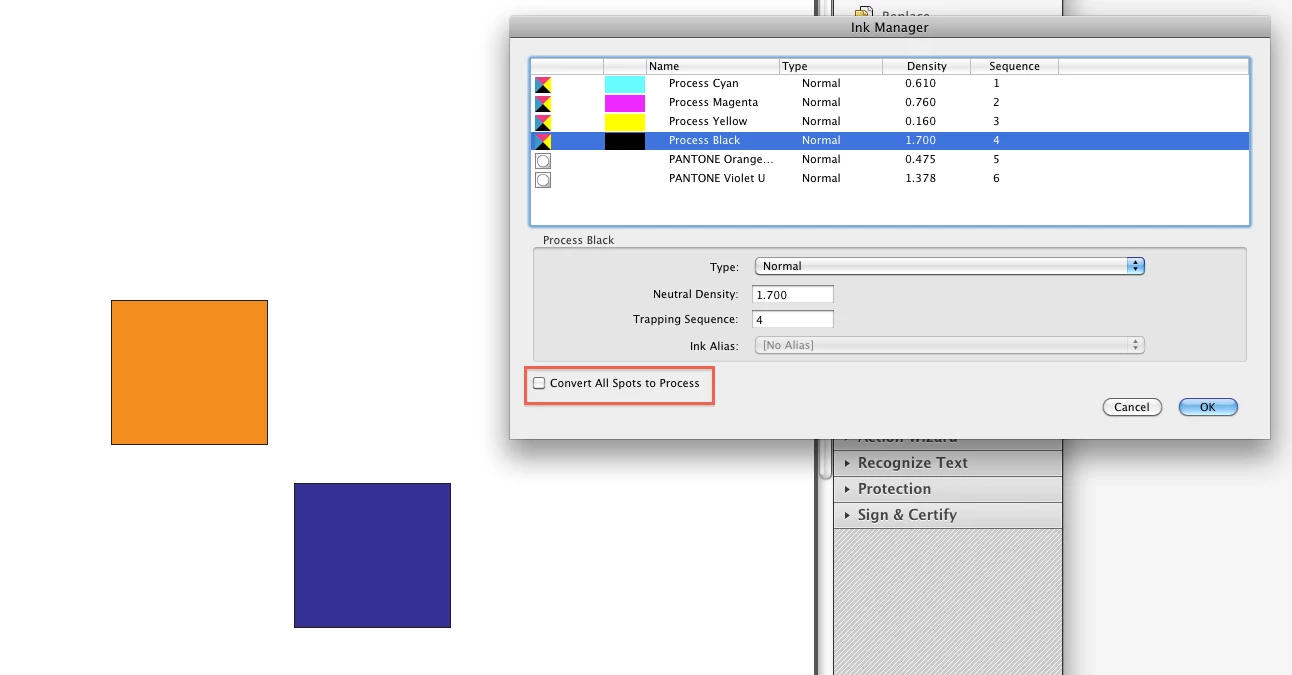

SRiegel Hey, I save pdf with no color conversation
Larry G. Schneider in InkManager, there are no Pantone colors shown
And there is one strange thing - I replaced one object's Pantone color with another but from the other Pantone color book, saved as usual and I see this color in InkManager. How is that possible? And as I understood typography handled it (replaced CMYK colors with Pantone I named)

The only one I can think of is in the Ink Manager dialog.
July 28, 2014

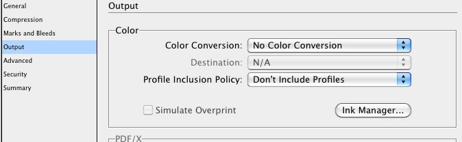

When you export the pdf, what are you color settings? No Color Conversion will retain your colors as Pantone spot colors.
