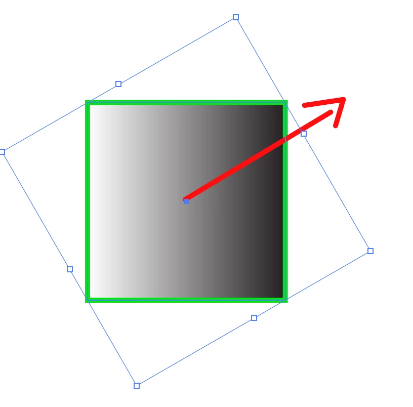

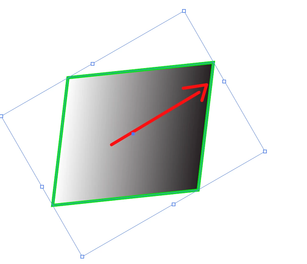

When you scale things, it only scales on the x, y, or both axies. I want to scale an object at an angle instead scaling at a combination of x and y. This is similar to if you had the bounding box rotated 30 degrees and then only scaling the x axis, it would effectively scale the object at a 30 degree angle only. currently the only work around ive found is rotating the object, resetting the bounding box, and then rotating it back so that the bounding box is at an angle, there must be a better wat to do this though.
February 16, 2020

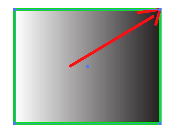

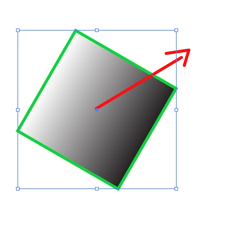

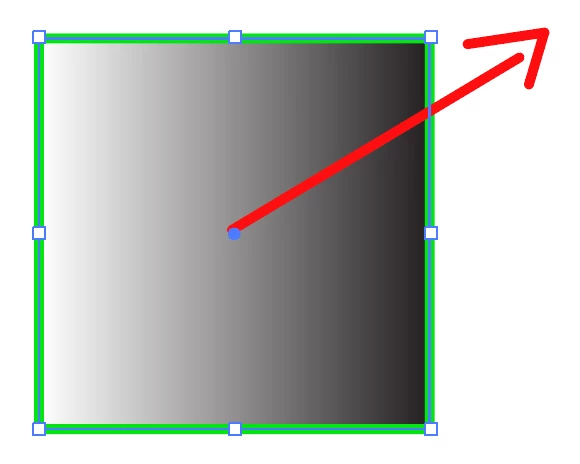

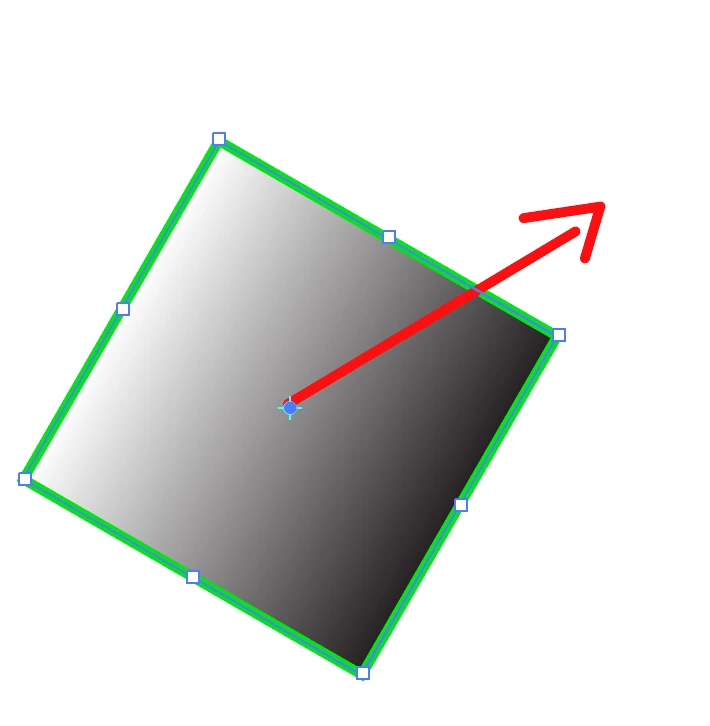

im attaching example photos of what im mean. First 2 images are what happens if i try to scale at any diagonal angle, it just scales a combination of x and y. The next 4 images is the tediuous workaround i found to scale at any diagonal angle. basically you rotate the opposite way, reset bounding box, rotated back, and then scale from one side of the bounding box. So im either looking for a way to scale one one diagonal axis, or im looking for a way to rotate the bounding box without rotating the object so that i can orient to do this faster.
