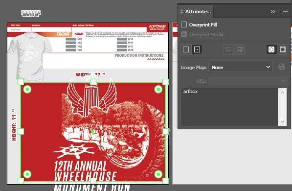

Hello, I'm trying to figure out how to script fitting a selected group of objects to an empty bounding box with the preset attribute "artbox". I don't know where to start... I usually start with someone else's script and then edit it to fit my needs, but I haven't found any similar script yet. But this is what I want the script to do in screenshots:
Here's the "artbox"
Here's an example art group that will be selected:

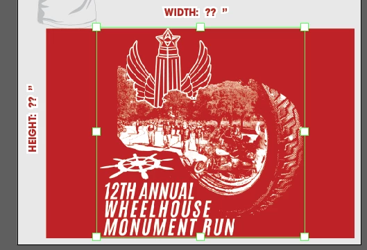

I want to automatically proportionally fit & center this selected art to the "artbox" like so:
