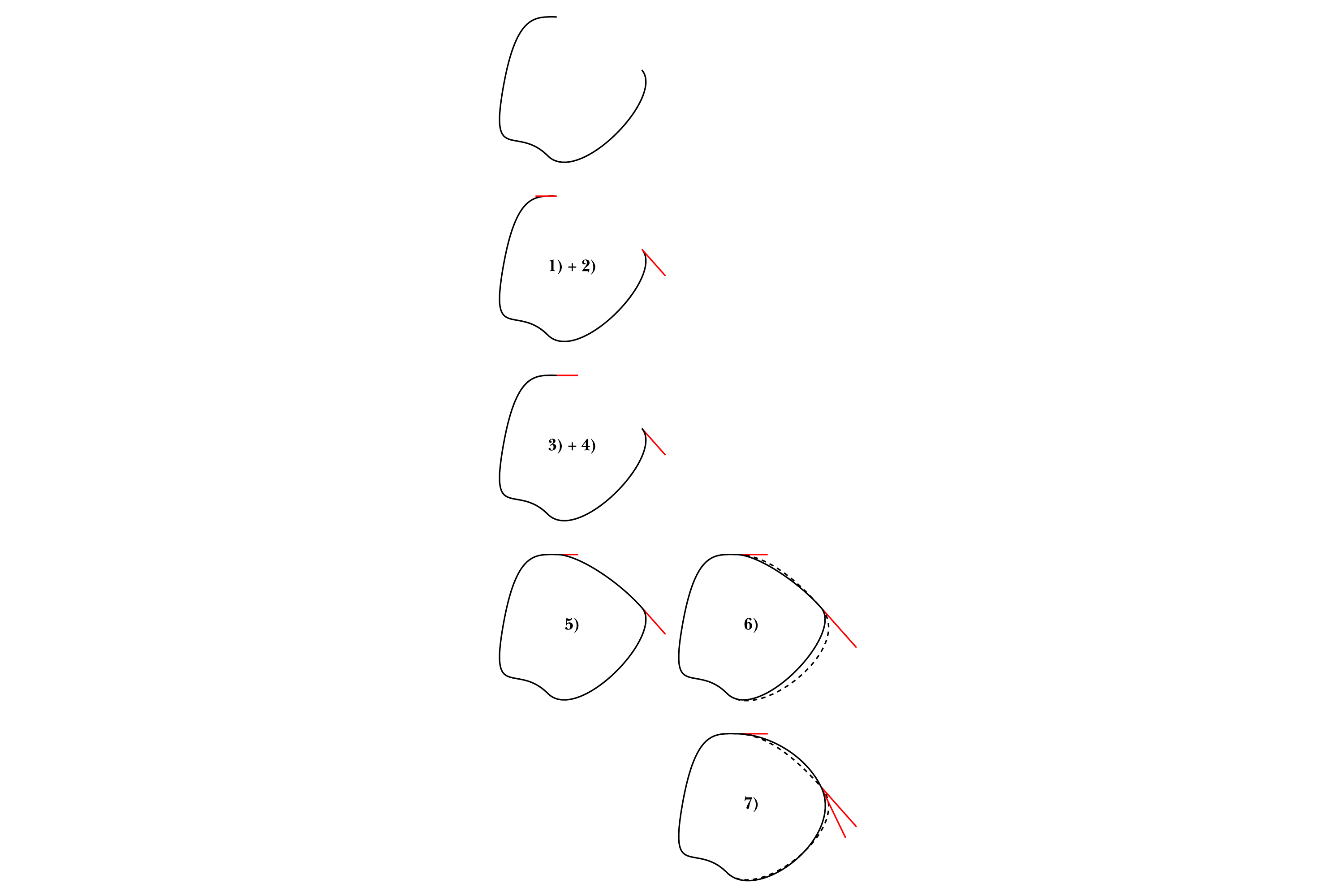

February 6, 2023
Mathias,
As I (mis)understand it now, you wish to join the ends of an open path in a way that preserves the exact shapes/curvatures of the end sections and gives a matching smooth new segment fitting in between.
In that case you may consider the following failsafe way, using the existing Handles, with the Line Segment Tool, and with Smart Guides being your friends, see the rather random path somewhat similar to some sorts of apples below (shown with a black stroke):
1) Deselect, then Direct Select one of the end Anchor Points with the Direct Selection Tool which will show the Handle, then with the Line Segment Tool hover to snap to the Handle (Smart Guides say handle when you are within snapping distance) then ClickDrag to snap to the Anchor Point; this will form the first guide line (shown with a red stroke);
2) Repeat 1) for the other end Anchor Point;
3) With the (normal) Selection Tool ClickDrag the first guide line by the end at the Handle to snap to the first end Anchor Point;
Now you have the guide lines in place;
4) Click the original open shape and Ctrl/Cmd+X+F (hold Ctrl/Cmd while you click the X key and then the F key) to bring it to the top;
5) With the Pen Tool ClickDrag from the first end Anchor Point to the end of the first guide line, then ClickDrag from the other end Anchor Point to the end of the other guide line;
Now you have the missing segment in place with symmetrical Handles at each Anchor Point, and the path is closed.
You can adjust the shape smoothly on one side of an Anchor Point and leave it unchanged on the other side by making asymmetrical Handles with the help of guide lines (scaled if needed) by ClickDragging one of the Handles along its guide line to obtain the desired shape.
6) shows a sample with such asymmetry where both guidelines are scaled up by a factor of 1.5 (to 150%), and the Handles are ClickDragged to the ends, so the left end of the new segment is changed as is the top end of the next segment; the changes are shown in dashed line on top of the original shape.
You can always more freely adjust the shape smoothly on both sides an Anchor Point with (further) asymmetry by ClickDragging one of the Handles free to change both length and angle.
7) shows a sample based on 6) which is still shown in dashed line, and the new Handle is (also) shown in red.
Click/RightClick and Click again to get closer
