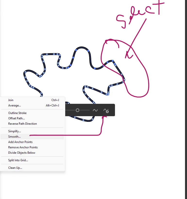

I think you can use Path->Smooth and smooth the selected part of your object.
I have a video about this in youtube in Armenian Language but hope it will help you in any case.
https://youtu.be/vVgwYZ2Ne3o?list=PL5h2UU0lvvnscuAM2eoyQMPSPJcYKqUPL&t=130

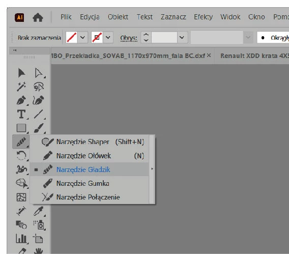

Try trackpad tool.
