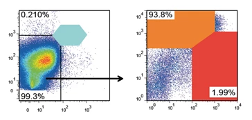

December 5, 2013
Hi Gustavo,
Thanks for your quick reply. Sorry for not being precise enough. I'm actually trying the following: I have several PDFs generated from some scientific analysis software we use in our lab. In these, semi-transparent areas from the program are due to some bug exported in full opacity (thus hiding the data points behind it), resulting in a practically useless output (see picture: red, orange and light blue shapes). While I'm quite fast in the task when using Illustrator's internal function to select objects of lets say 'same fill color' and then changing their opacity, I would like to use a script to automatize these few but annoying steps. Maybe my approach of looping through all pathitems is not the right one in this case? I think the objects I'm refering to are paths within groups, but I'm rather new to Illustrator vocabulary (and scripting, obviously), so I might be wrong.
Here is a picture of the faulty output I'm trying to correct in illustrator:
I'm not sure if I can post example files in this forum or if such links are removed for security purposes, anyway, I'll try: Here is an example PDF (smaller than the usual files but it illustrates the problem): http://wikisend.com/download/552752/example.pdf
Thanks again for your interest in the problem!
