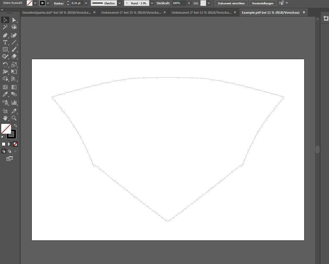

I have a large figure (the original file can be found here​ or also here in pdf format):
This figures size is approx. 255cm x 160 cm. This is quite large. I want to print this figure (in original scaling, so not smaller). However of course I cannot print that large file. I can only print usual A4 papers.

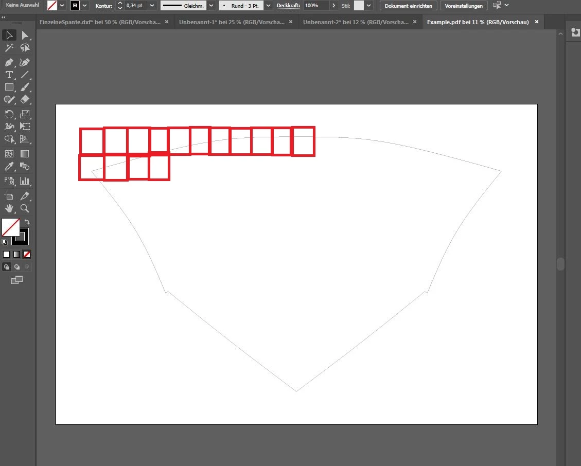

I now want to split the figures into smaller A4 pieces and print each of them and later put them together. So here is an illustration (I just entered a few A4s and the size is also just guessed):

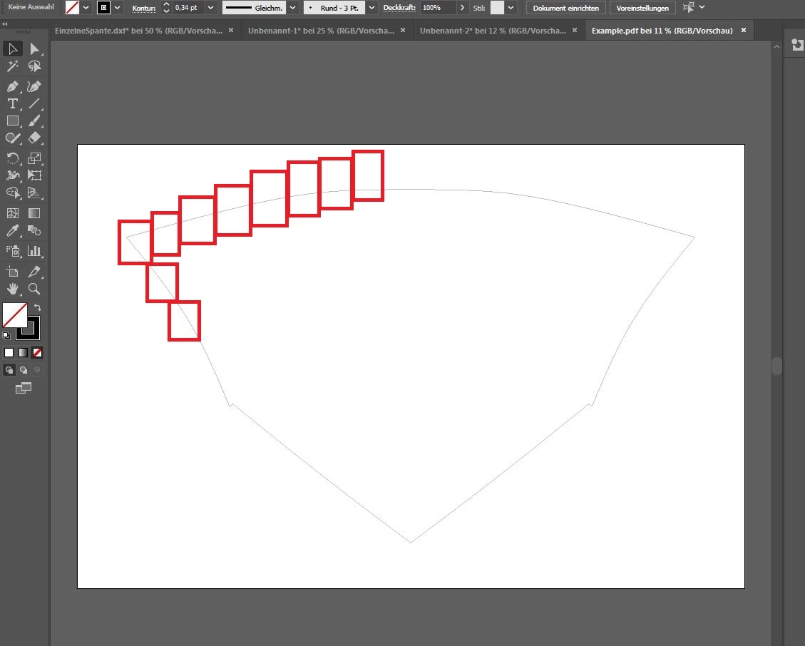

It could be also like this:
