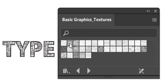

    Correct answer barbara_a7746676
    If one of the textures that comes with Illustrator would work for you (Swatches panel menu > Open swatch library > Patterns), or any vector texture  that you might find on the web, then you wouldn't need to bother with a clipping mask. The text in the example below has a black stroke and a texture fill.
    If you need to use a raster image texture inside the type, File > Place the image. Put your type on top of the image.
    Select both the type and the image and Object > Clipping Path > Make.
    Would either of these suggestions work for you?
    barbara_a7746676
    barbara_a7746676Community ExpertCorrect answer
    April 27, 2017

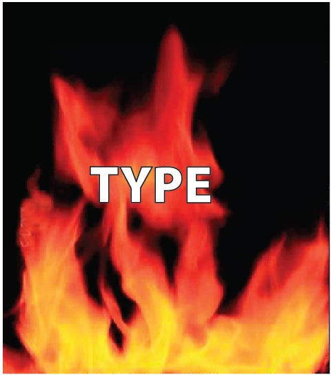

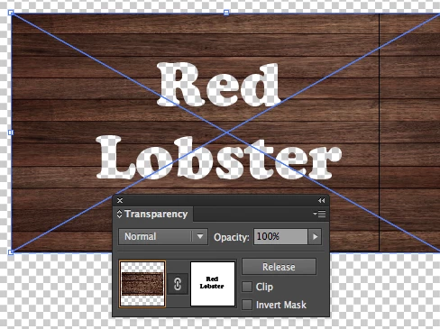

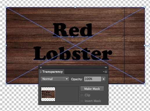

    Mike_Gondek10189183
    April 26, 2017
    Select a texture, and some black type.
    Click Make Mask and change the checkmarks as shown.
    I am using Shift Command D to show transparency, a key command to toggle that on and off.

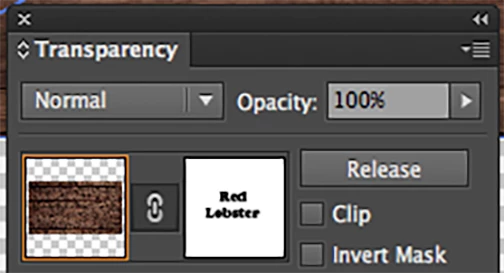

    Mike_Gondek10189183
    April 26, 2017
    Not there are 2 thumbnail s in this palette with a golden line around the one thumbnail in focus.
    If you wish to edit the mask in the future  then click on the right thumbnail and the golden line will move to that. This is the part that usually hangs up everyone when they use this so just remunerates there are 2 thumbnails and you need to be in the correct one to either edit artwork or the mask.
