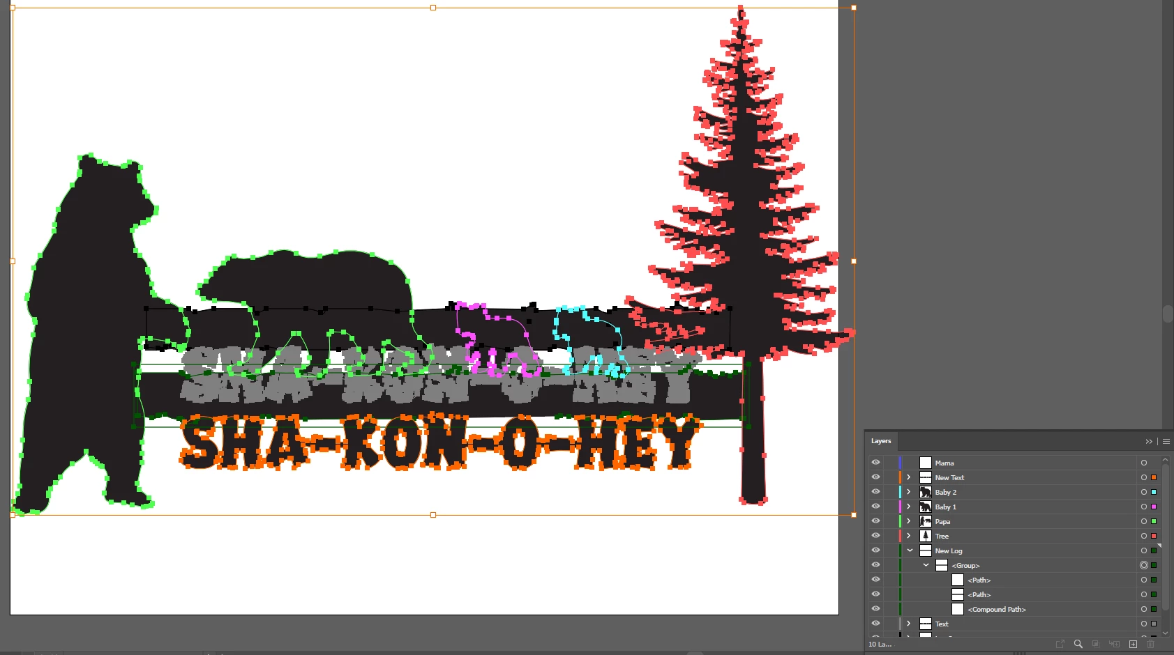

I have created a sillouette illustration comprised of some bears and trees that I want to send to my laser and cut out the sillouette on a sheet of aluminum.  I always end up with excess or non-existing lines in the artwork and the laser software will not accept the file.
The path I have taken is to create the sillouette, save as a tiff (hoping to remove any extra lines and points), re-open in Illustrator, Image Trace as a B & W Logo and export as an Autocad DWG file where engineering cleans it up a bit.  However, the laser software sees the image as incomplete, missing lines and details.

As @Doug A Roberts  said, you see that it is a simple artwork, but if you select it or press Ctrl+Y you can see more unnecessary lines and shapes. Youcan select all and from Window>Pathfinder Press on Unite icon to merge it in one shape.

Is this what you want to end up with?
 Bear sign
It is a relatively simple drawing, but it seems to have been created in a confusing way. There are unnecessary compound shapes, hidden layers etc. that need to be removed.

The PDF I end up with looks just like yours.  If there are hidden layers and artifacts in the file I am not aware of them nor would I know how to eliminate them in a timely fashion.  I figured that if I converted to an image, such as a TIFF or JPG, it would eliminated any hidden items and by using Image Trace would give a single line or path around the entire silouette.  Not so?

In Illustrator, with the hidden layers shown and everything selected, your file looks like this:
The text is a compound shape; this should be released and converted to a compound path. The log has a no stroke/fill path around it which should be deleted; the hidden layers can simply be removed. There is no need to export a TIFF and use image trace -- fix these problems and then combine shapes with Pathfinder and you have a single silhouette shape.
