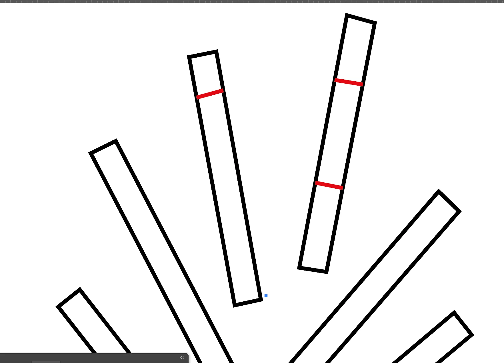

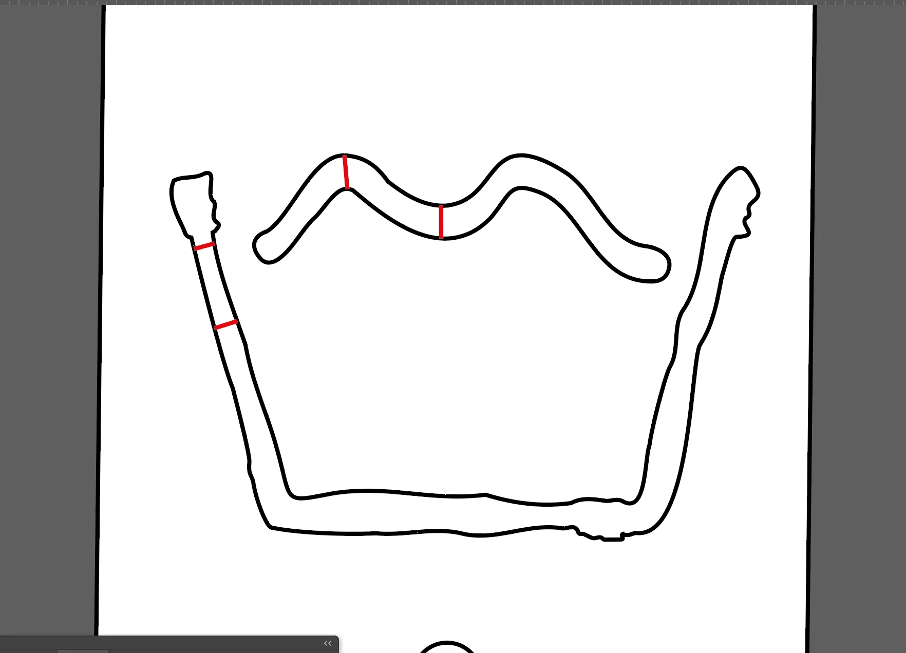

English is not my first language but I think I am more talking about bouncing box because my objects are not 1 stroke + contour but closed "stems"
I made a screenshot, I would like to make sure that all the red "measurements" are at least 2.3mm
do you think smth exists for that ?
(i don't necessarily want to make all the width the same, I would rather make sure none are under 2.3mm)
thank you very much for your help !

OK, you can safely forget any automatic method with that handdrawn looking shape. Draw a circle with the diameter  of 2.3 mm and move that circle in that shape.
The rectangles: when you select them, are they still Rectangles in the layers panel? If so, you can select them all and just enter the desired width in the transform panel. Make sure to turn off proportional scaling for that.
If they aren't rectangles, then: is the bounding box rotated in the same way? If so, then the script might work (I'm not sure what it does with rotated shapes). If the bounding bos is not rotated, then you need to use the circle method as well.
