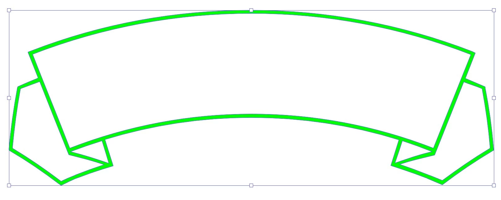

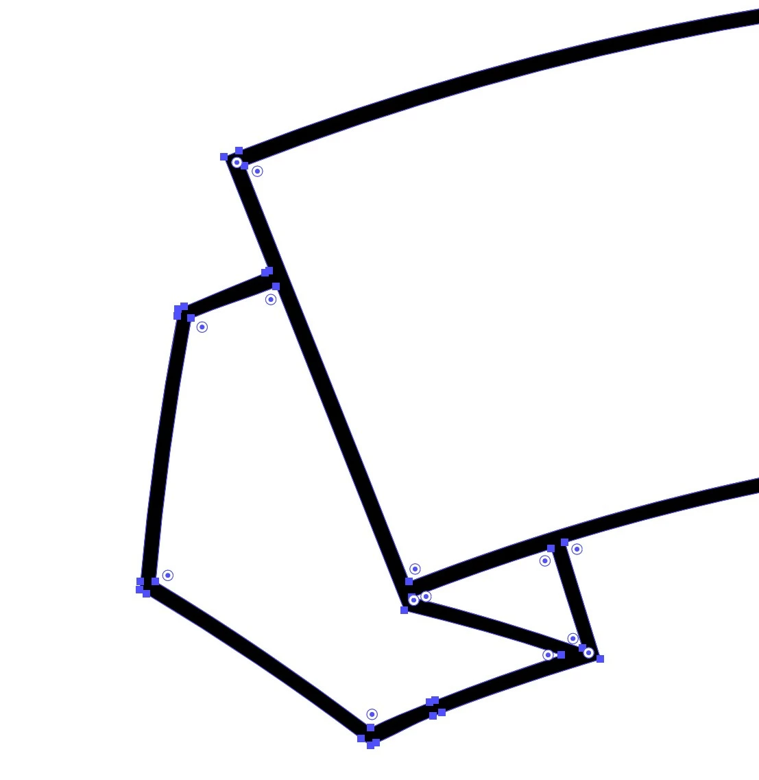

Thanks for your reply Larry. Unfortunately, I believe that's the opposite of what I'm looking for. It's not that I'm trying to turn paths into filled areas; it's that I've got a bunch of assets in which the creators already did that prior to releasing/selling them. Now I can't figure out how to use these objects because the filled area is the inverse of what I need.  (I added examples below)
What I'm looking for is some info on why creators do this (it seems to be a regular habit?) and direction as to how I (an end-user) is supposed to use an object with a filled path. In the sample, I can't fill the ribbon because the outline itself is the object and the only fillable area.
Met1
July 18, 2022
Release the compound path, Alt+Shift+Ctrl+8 (not sure of Mac equiv).
