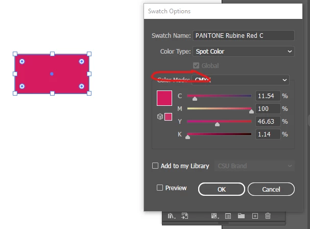

Michael the person who taught me how to color trap and do pullbacks, for print over 35 years ago was color blind, so hope I can be of help to you as he was to me.
I would double-click on the color in swatches. If a spot color like PMS you can temporarily switch the Color Mode to see the numeric values, then just cancel.
